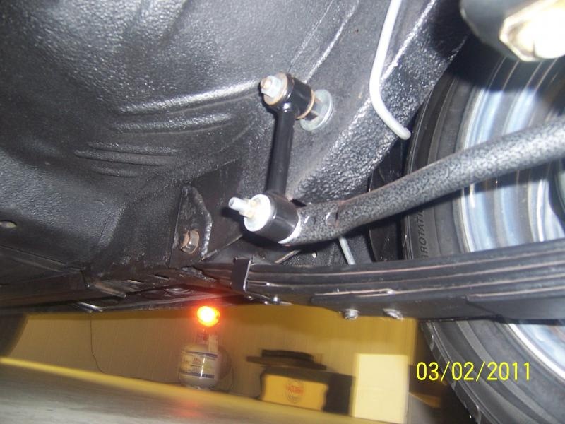

If I want to run the sway bar (hellwig 6908 ) the shocks have to go back to the original location because the sway bar wasn't made to clear front mounted shocks.
For the shocks to fit back in the stock location I've got to move the axle back to the stock location on the springs.
Then to find out there is little to no clearance between the springs and the sway bar ends. The spring relocation boxes were put flush to the outside of the frames. If i would have centered them it probably wouldn't have been an issue!
Having issues finding the correct shock to go with since its lowered. I believe i need something in the range of 12.5" compressed 19.5 extended.

I'm up for any advice on resolving those issues.
I could forget about the rear anti sway bar but it would be really nice to have. Plus I spent the $$$ on it and don't want to take a loss on selling it.
Could also cut out the upper shock mount bar that is welded in. Remove the stock mounts from the trunk and move the bar back.

Sounds like you are kind of out of luck on the rear sway bar. I can't see the pic to have a good idea of what's going on. Can you modify the bar to make it work? What about contacting Hellwig and exchanging the bar for a custom shaped bar that will work for your application? It's more money, but what about a modular bar? I ordered custom length and sized bars for my application and am building my mounts and arms. Just a thought. Otherwise, your idea of moving the shock mount bar back "might" be your best option.

I had my Hellwig bar bent to fit my application ( they didn't have a bar to fit a narrowed 9" in a 63 Dart.....) I made a template out of wood and brought to my local spring shop. He charged me $75 and did a great job, fits like a glove. (Just don't heat it..)
Don't put the swaybar links between the sway bar and springs, mount the swaybar links on the inside of the sway bar and then make a spacer to the frame. This is not mine, but like this:
attachment.php
Thank you for trying but that's how I have it. The head of the bolt contacts the leaf spring on both sides.
I'm going to try the carriage bolt. If that doesn't do the trick and I can't come up with a good solutions, I will let you know.
Thank you.
The carriage bolts won't work, It will still hit.
Options-
A: I cut out the spring boxes and put new ones in but moved for sway bar clearance.
B: Say to hell with the anti sway bar, move the axle back 1.5" to were i had it.
I could go either way. If you were in my shoes what would you do?
Options-
Move the axle back into the stock location.
Reason is if you ever want to run some bigger tires they have the possibility of rubbing at the back of the wheel well.
I have 325/50/15's on mine. Some guys were trying to tell me to center the tire in the wheel well. I am glad I did not listen to them cause the tire would have never fit. I would have had to cut all my link bars back down and put it where it is now. Just an FYI
The math is telling me its almost a 28" tall tire. Did you have to trim the front of the quarter to give you more room in the wheel well since you kept the axle in the stock location?
