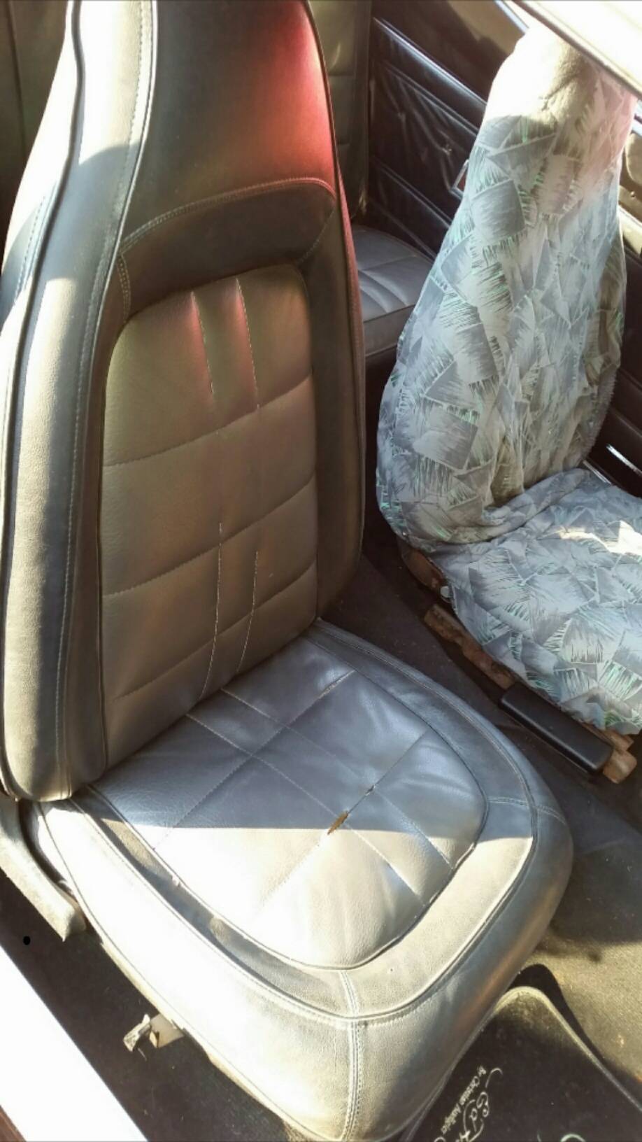

These are the seats that my mother in law fixed for me in the Camaro
Yea man! Looks good. .030 for an overbore is ok and fine. Which speed pro Pistons did you get? I just did there hyper-U slugs.
Also, the "J" heads are basically the same as the X heads only with normally seen smaller valves. They will port out very well. There should be no problem making power with the J heads. I have run in the 12's with stock J heads. It takes a good bit of a heavier cam and more gear to do so verse a ported head. But it is cheaper.
(Oh! Camaro seats look really good.)

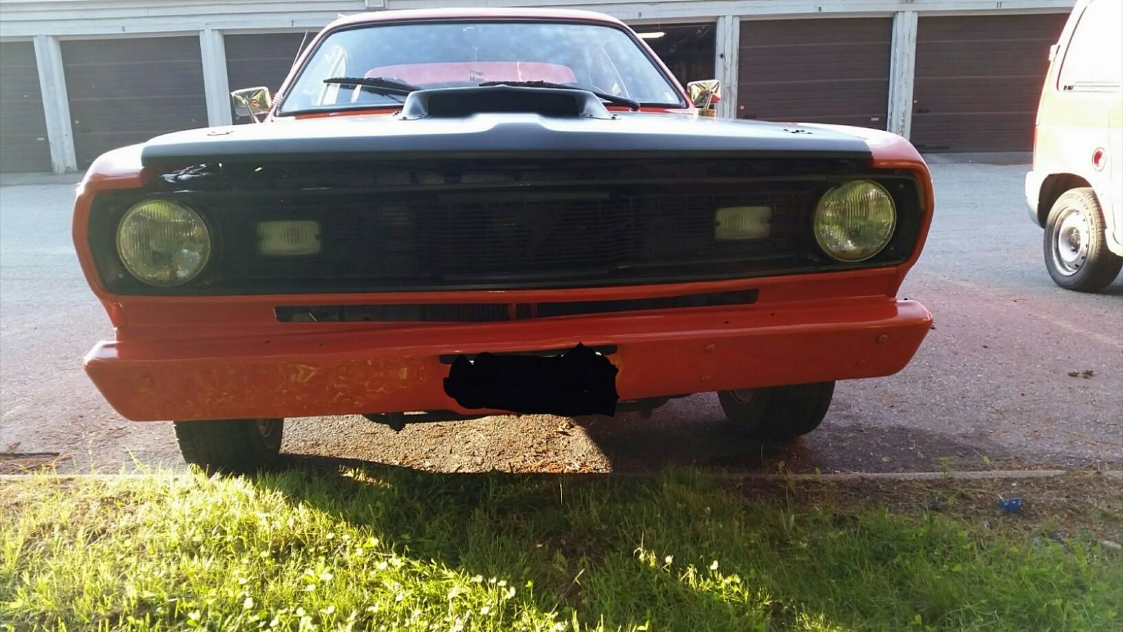

I was in a bit of a hurry when I got the car, so I didn't take much pictures outside of the garage. I'm hopingto get it out for a test drive at least, before the snow comes.
Never assembled an engine before and I still have to shorten the drive shaft, check my engine mounts and stuff.
It will be orange, though ;)
