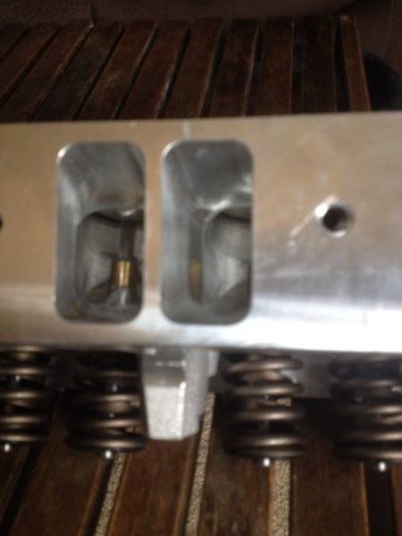

Engine wise, I’m sonic checking 340 blocks now for a suitable one for a mini (Ol’ tyme) stroker. I have a forged 3.58 (360 CID) stroke crank for the 340. I got it stupid cheap. $425 delivered to the house. Piston size to be determined by the blocks capability. 372 CID or more.
I have most of the engine parts waiting there moment. They are;
6 pack air cleaner a/K&N filter
Carbs are brand new with Pro Max enhancements
6 pack manifold pro ported
Edelbrock RPM heads, pro ported w/2.08 intake valves
Solid roller cam customized and speced by me. 248@.050/.600

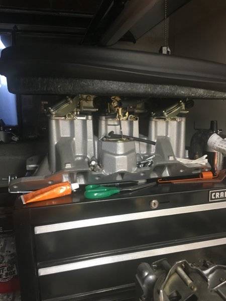

View attachment 1715383384 View attachment 1715383385
Just gotta love six packs.
My dad bought a 1971(i think) challenger 340 six pack some twenty years ago, original side pipes and stuff.
He had to keep special papers in the car for when the the police pulled him over because its not really allowed in Sweden.
I've tried buying it back but they är really, really expensive here so that will probably never happen.
