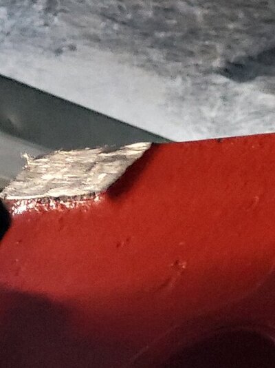

I ground a couple cast iron lumps off the side of the block.
The last time I mounted the intake gasket these interfered with the gasket.
