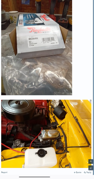

Hey again, been waiting for parts to arrive, but I believe im ready now to begin this probably painfull process. My first issue is I dont have a vice, and everywhere I look it says I must bench bleed the replacement MC with a vice before I install it in the vehicle.
I've checked my hoses and I dont see any leaks, so im willing to continue with them the way they are. I have one of those standard brake bleeding kits with the adapters and the hoses and bottle and stuff, as well as access to a handheld vacuum pump if that method would work better in your opinion.
I've seen somone bench bleed the MC by installing it and using the brake pedal to actuate it, but I've also heard that that doesn't fully work, I'd like to hear your opinions on the matter, and if required, maybe some tips for bench bleeding without a vice.
Thanks in advance.
you can "Bench Bleed" mounted on the car. IT just needs to be fairly level jack up the rear of the car if need be. Have someone else press the pedal so you can control the fluid level etc. and have them press and release the pedal really slow. be prepared to have spillage so have towels etc. under the master while you do the "Bench Bleeding"
the tried and true is down, open the bleeder, close the bleeder, up (SLOWLY), down, open the bleeder, close the bleeder, up (slowly) and keep doing that till no more bubbles from that line longest first RR, LR, RF, then LF.
BE SURE keep an eye on the fluid level in the master, if it gets too low you have to start from the begining.
It works just fine and just the same as in a vice BUT the master needs to be level
