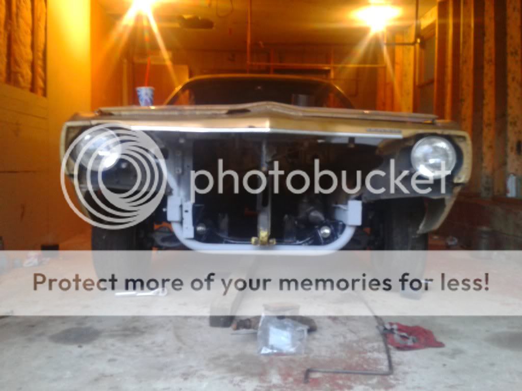

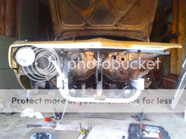

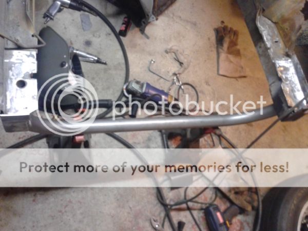

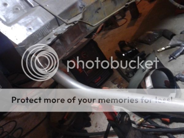

I haven't posted anything, but I have done a little work. Got my tubular radiator support welded in, made sure all was level/straight. I had to do a little repair to the inside of the drivers side front subframe, right at the front, from the battery that exploded at one point. It was weak, so I replaced a part, reinforced it, and made a new top piece for the front of the subframe. Here are some pics from my cell, I forgot my camera.
Today, I started to re-attach the radiator support pieces, as the PO had removed the whole radiator support to repair the rust caused by the battery. I didn't get pics, yet, but I will! Tomorrow, I am going to start removing the inner fender, and also removing the inner fender from the good front clip I have.

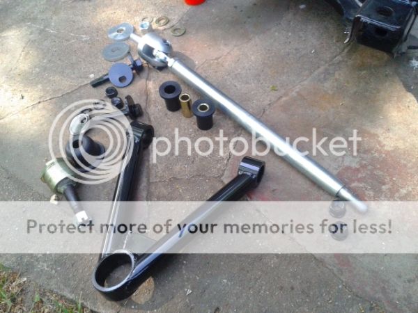

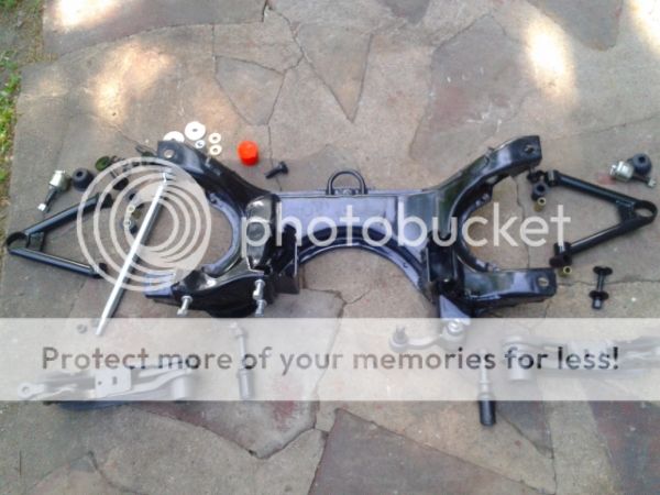

Just got the uppers from Badart, and pretty much everything else came from FABO members! 76orangewagon did the strut rods, k-member, etc. Only thing I already had lying around was the lower control arms and cam bolts! Which I will be making my own sway bar tabs for the lcas.

Still have to finish repairing the radiator support, the po removed it to repair some rust from a leaky battery. I gots the peices, just nots the time! Yet. But, here is the last shot before I went home.

---got a set of new .920 torsion bars from a member on here! All I need to do is get the solid tie rod sleeves, some 11/16 rods, and fab up my lca sway bar tabs, going to go with a bushing on the bar/heim joint on the bottom. That stuff will wait till spring, tho.
