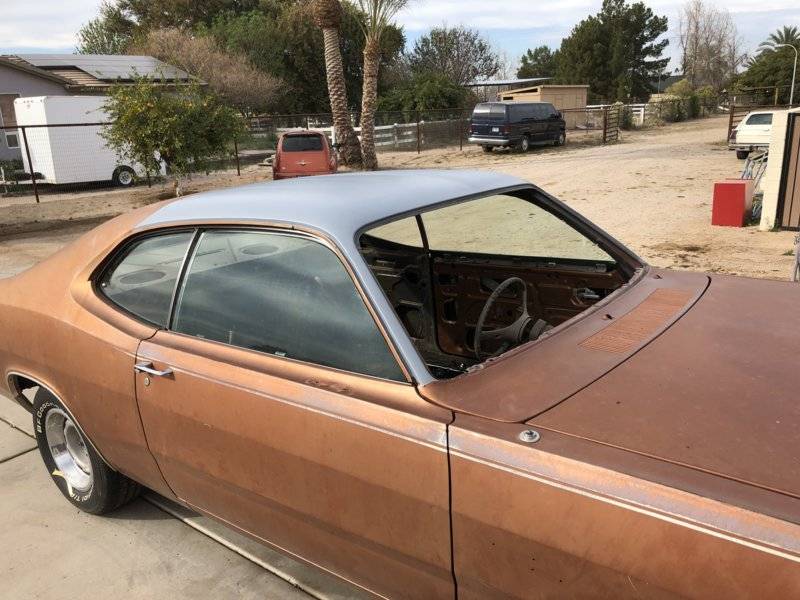

1974 Dart Sport “Desert Rat”
Wow looks like you have a nice start. The paint looks amazing to be original. I love that color although im partial that was the original color of my 75 dart too!
I test buffed the front filler panel to see if I would be able to achieve the perfect patina look with the original paint but still have it shine nicely.
I really can’t wait to see it all polished with the new stripes and vinyl top!

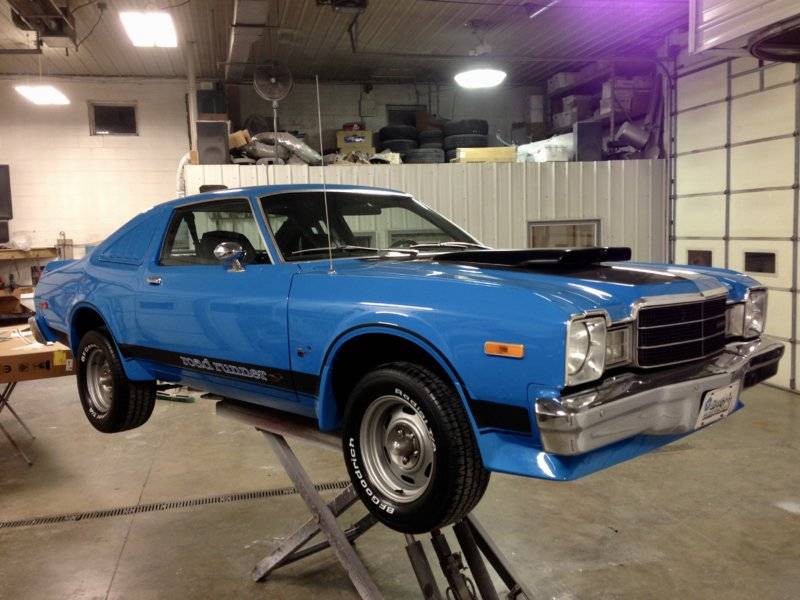

I think I want to do a AAR-T/A style blackout on the hood and cowl with a 73 style scoop (of course! I had one on my 77 4 speed Petty Blue F body Roadrunner and loved them since!) sonce the hood has some dents I’d like to fix anyway. SEM Hot Rod Black kit or some 9700 Black and some cheap matte clear (I’ve used and liked) in the past.
It won’t be OE correct but hopefully will be a no harm no foul being it’s just a 318er that isn’t number matching and could be put back to 100% if wanted when properly restored.
Tail panel will receive a matching matte finish also. I think the matte black will look nice with the brown/white/parchment combo.
I wish there was a rear deck spoiler like that one on the Roadrunner! The blackout (and scoop) are not correct but that could almost pass as factory and that’s what I always go for with anything I build.

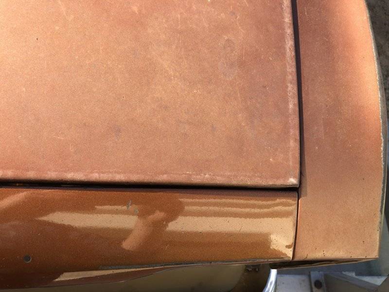

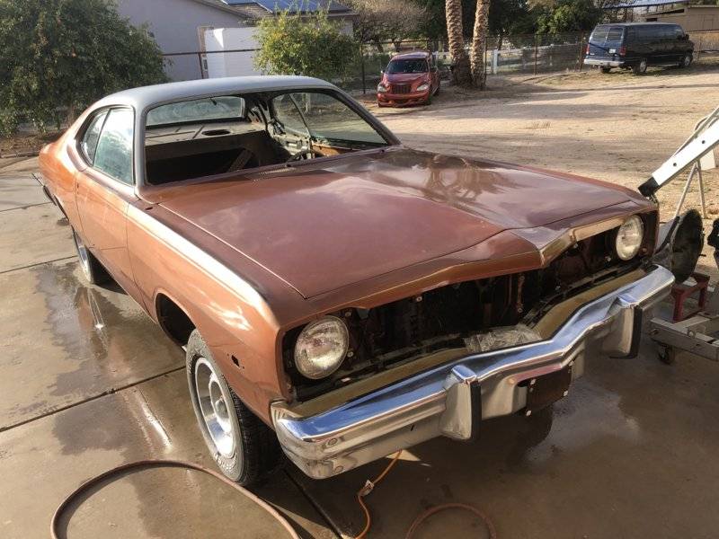

Here’s a peak at the paint. Light cutting compound, wool pad and about 1000 RPM should give me the perfect marrage of original and weathered (patina)
I’ve been doing paint restoration for 20 years or more and really love doing this to something worthwhile.
View attachment 1715268367 View attachment 1715268368 View attachment 1715268369 View attachment 1715268370 Here’s a peak at the paint. Light cutting compound, wool pad and about 1000 RPM should give me the perfect marrage of original and weathered (patina)
Looks good! Is that color T5 ?
I really kick myself for repainting my car. When I was a kid I hated the original color now that im older I love it.

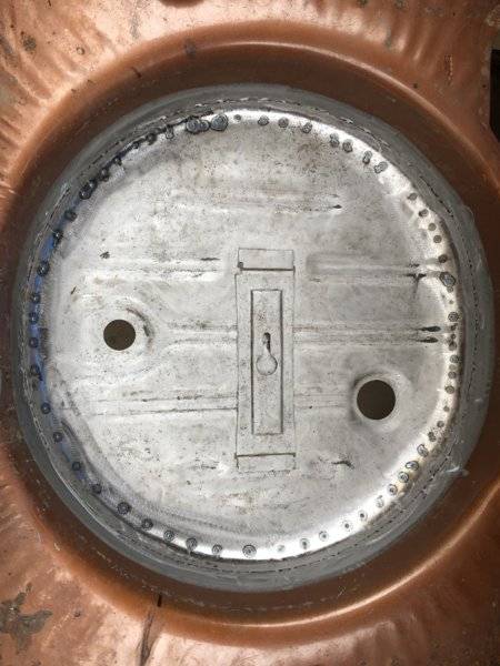

- welded in replacement tire well

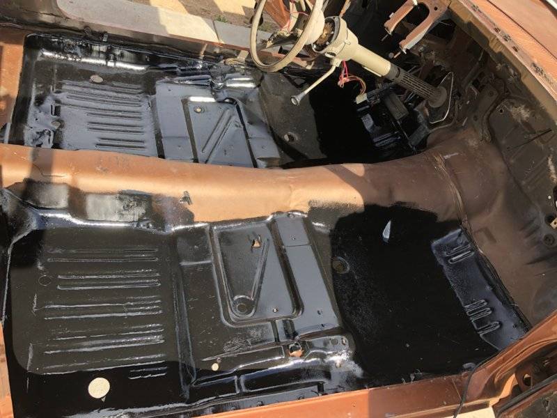

- POR15 floorboards

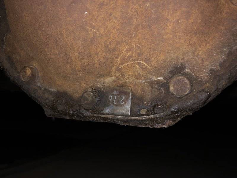

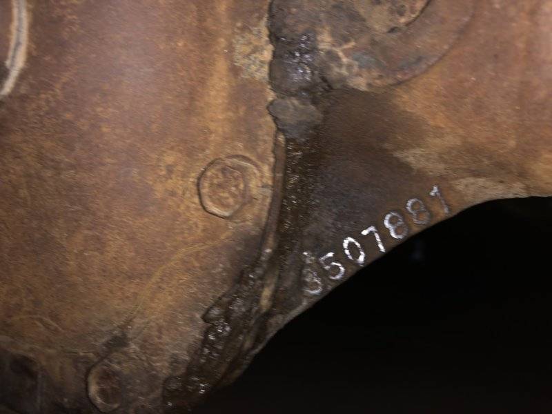

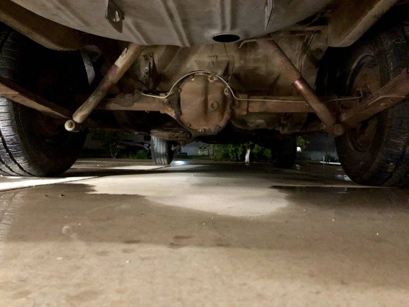

I need to figure out what rear end is in my Dart Sport? Obviously I’d love to put a 8.75 in as I have 3 extra 489 center sections... but damn are they pricy!!! And I’m cheap when it comes to this one.
I’d like to have a sure grip unit and 3.55-3.91 gears in the original rear end. I wouldn’t ever hurt it, now the next guy might!
It won’t see strip duities, only an occasional burnout or two!
Obviously it’s a 2.76 open rear. But what size... 7.25?

Mine had a 8 1/4 and it always seemed like the rear tires set in and we're on a narrower track than the fronts. I had a 8 3/4 with a 3.91 sure grip from a 66 charger that I relocated the spring pads on and it made the rear tires sit centered of the wheel wells. Hard to tell with the new wheels on but the track looked right while it had the stock rallyes.
Part of the problem is that the bulging quarter panels give the impression of the axle being too narrow. Also, if this is a front disc car, the disc brake setup has a 1 inch wider overall track as compared to the drum cars.
The 68-70 B body 8 3/4" axle is an excellent swap. It has the desired larger bolt pattern and fills out the wheelwells using even a 15x7 wheel.
Would this require moving spring pads like Sport74 was talking about?
That is what I am told, not much and you can force it but to do it right they need to be cut off and rewelded. I am going to get mine 8 3/4" this weekend if all works out so I will be documenting the surgery in my thread in the coming weeks.
1972 Duster Build with my Daughter
Yeah, but it is an easy job. I've done it several times. The B body axle is NOT a good fit for any Valiant or Dart EXCEPT for the Demon or Dart Sport. The low hanging wheel opening arches make for a real tight fit.
