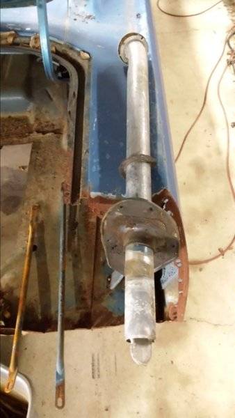

Here we go. Been wondering what the rockers looked like under the pan. All good so far.

Haha I'm sure they do. It will make this job easier, that's for sure. First time I've used one in years, on my first pan. This is fun!
Pan is out except for the strip along the firewall. Lots of prep work next too.
Last of the pan separated from the firewall. Encouraged by the lack of serious rust I'm seeing.
