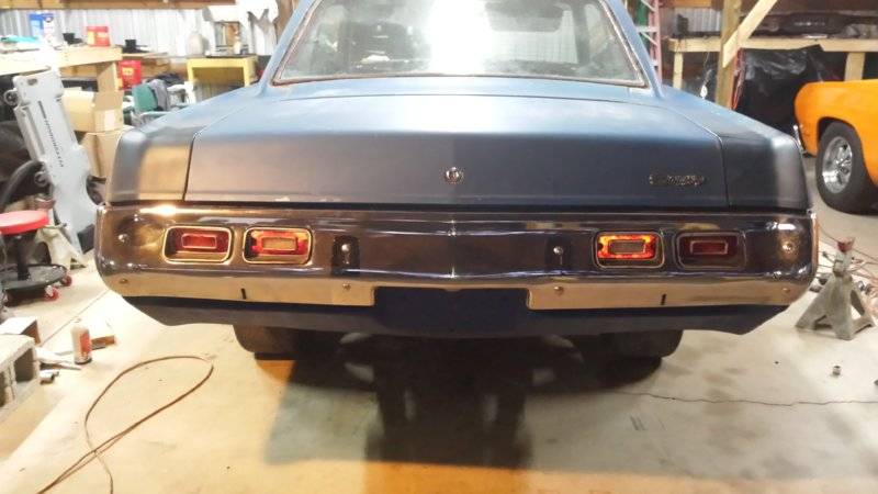

Power up test. Bumper installed. Had to replace all the bulb sockets. They were trashed.

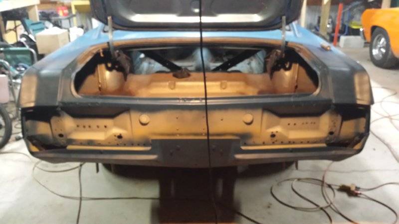

Next up. Probably could have saved the tunnel and the seat mounts, but I figured it would be easier to pop the whole pan out. Less fitting and welding in the long run.

Are the quarter extensions different or does the bumper set where the old taillights should? Obviously you have to add the bottom valance metal where the old bumper was.
Quarter panel end caps are different. Also, left and right tail panels, center tail panel, bumper and brackets, and yeah rear valance all different on a 74 up.
Biggest pain was tweaking the rear caps to align them with the rear quarters. Especially since I had one broken stud. Had to drill and tap that for a screw.
