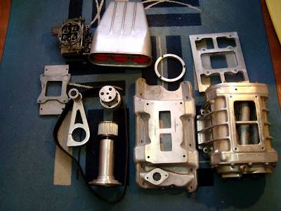

@65TerrorCuda I found this 4-71 cast manifold while surfing the net. I know you have a MaxWedge manifold but I thought this was interesting.
View attachment 1716005980@65TerrorCuda I found this 4-71 cast manifold while surfing the net. I know you have a MaxWedge manifold but I thought this was interesting.
Very nice, wonder who made that setup? That 4-71 to 6-71 adapter plate looks like mine.

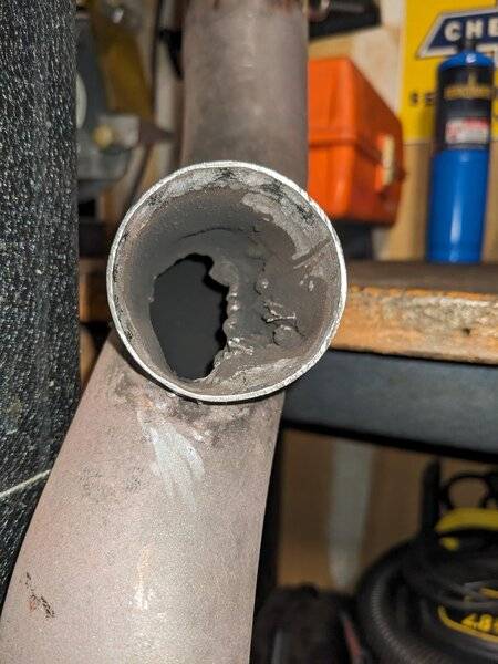

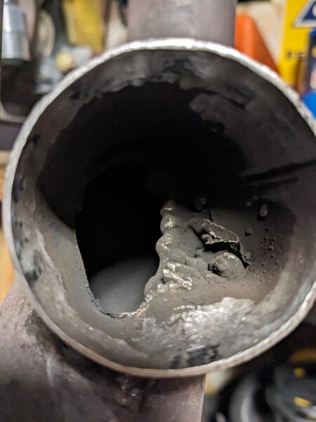

Here's what a plunge cut with a stick welder looks like. Granted this was a cheap dual exhaust I had a shop install 20 years ago I can't complain too much. Mufflers are flowtech raptors which I really like, but could never see what they were because they installed them with the logos facing the floor and 100% welded in place.
I asked for 2 1/4" exhaust and they did 2 1/4" to the mufflers, 2" behind the mufflers, and 1 7/8" h-pipe.
Eventually probably replace everything with 2 1/2 stainless as welding dirty old metal really kills the tungstens

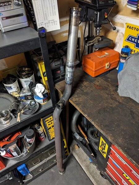

Everything getting tig welded v-bands so I can actually work on it without squeezing between pipes.

Pulled another 8+ hour day cutting and welding the exhaust. One more v-band to go then finish weld everything up. Ugh I hate exhaust

Figured out most of my problem was not using acetone to prep before welding. 99% better welds and zero fudged up tungstens after a visit to Home Depot. $24 a gallon but worth it
This was my first major welding project. I also learned a wipe with acetone is a must and fit-up has to be very good. If you’re doing stainless I like purging the inside with argon while welding as well.
That is some tight fit up you did there, well done! Nice welds too. I love how stainless welds but working it makes smoke pour out of my ears in frustration.
