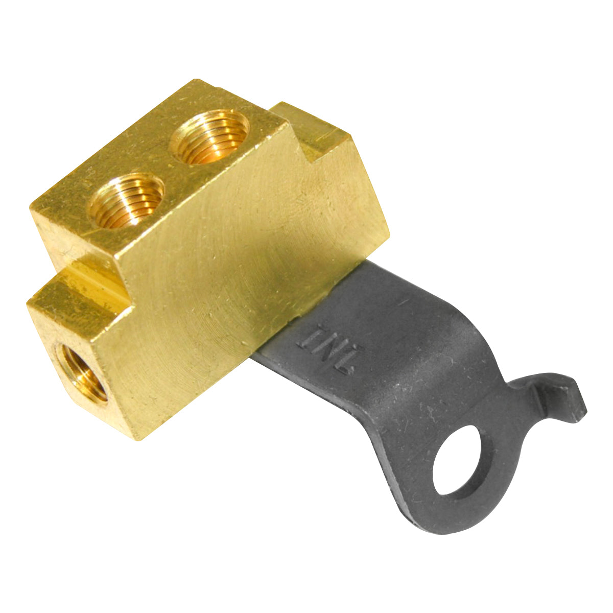

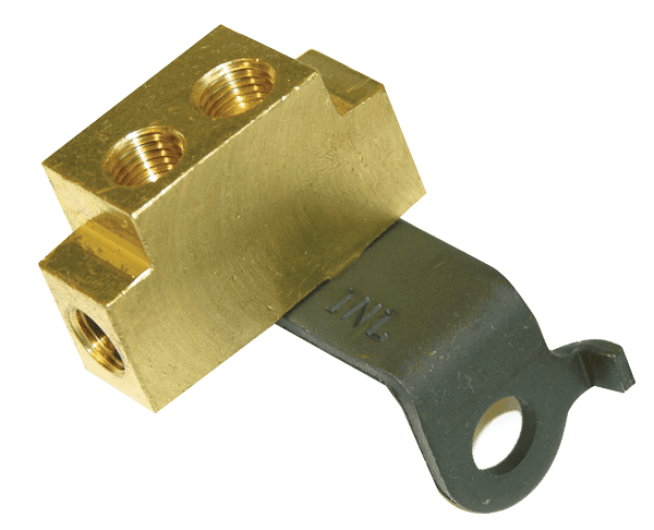

This one is weird. I've never seen one before:
no.... the early mopar distribution block has 2 circuits... the front in then left/right out and back in and out.. can actually just skip the back and go from the prop valve to the rears but the line was already at the distro block.. sooo
This is the most common 4 wheel drum distribution block that I have seen:
These have no proportioning to them. Ma Mopar achieved proportioning through the drum widths and wheel cylinder sizes.
