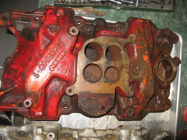

For what it's worth I do have an early 340 cast iron manifold 3462848 I could try if it's compatible with the 360 engine. Any thoughts?
Is your intake spread/square bore. I'm guessing so. If you don't have the plate you could very well have a nice leak between carb and intake.

You need the plate if your intake flange looks like this...
You can try that 340 intake if it has the square-bore-style flange.
attachment.php
attachment.php
Those 2 pictures are exactly the manifolds I have. So it sounds like I do need an adapter if I want to use the Edelbrock or I could possibly use the old 340 intake with no adapter.
If I do choose to change to the 340 manifold is it totally compatible with the 360 or will I have a head angle issue to deal with?
You should be fine, assuming the heads haven't been played with, etc.
That 340 intake should bolt right on with no issues. IF it were me, I'd spend the ten bucks and install the plate, much easier in the long run.
