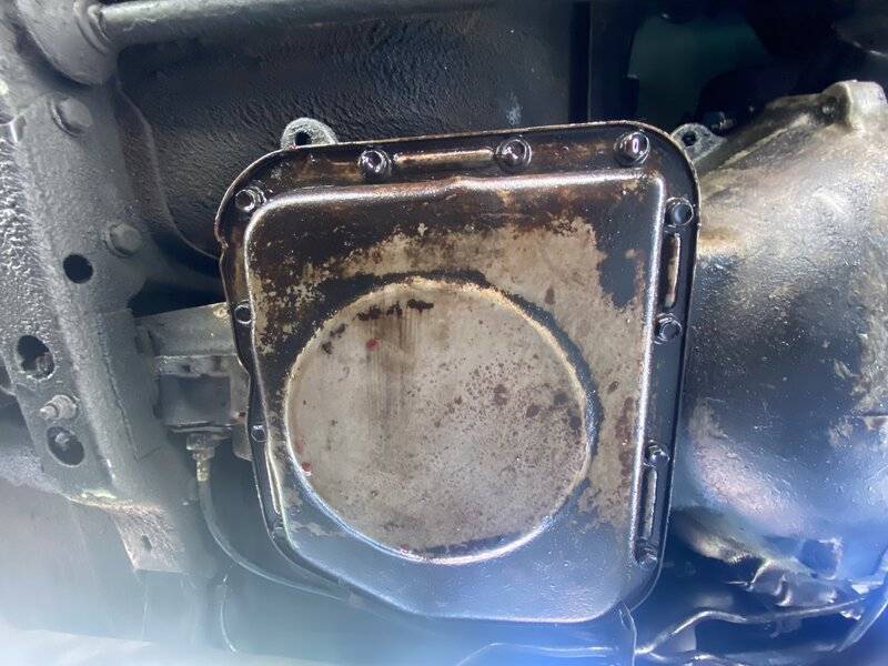

I’m trying to wrap up swapping a junkyard 318 for a ‘72 J head 360 and I’ve ran into problems trying to start it and finish up this project. I left the stock 727 trans in the car with stock converter but I bought a B&M weighted converter,BMM-10236, with a summit brand weighted balancer. I first installed the starter from the 318 and when I hit the ignition the starter would spin at what sounded like a million miles an hour. I figured the solenoid wasn’t firing so I tried hitting the solenoid a few times and it didn’t change anything. After some more hitting it sounded like the solenoid was firing but not spinning. I work part time and a full time student so my dad pulled that old starter for me and bench tested it and found out it wasn’t working. I bought a remanned starter from O’Reillys and got it all installed and buttoned up but got the same results. Hit the key and it just spins. Hitting the starter does nothing no matter how much I do and I’m out of ideas. So just looking for help and knowledge cause I’m out of ideas and I’d rather not have to pay a shop to figure it out for me but that’s about where I’m at. Thank you in advance.
Are you SURE you've got a 727, and not a 904? Most 318s came with a 904.
Using a B&M 10236 in a 904 will result in the Bendix gear being blocked from engaging the ring gear on the convertor, which is exactly what it sounds like is happening to you.
A 904 requires the use of B&M 10239, which will give you the clearance you need.
Easy way to tell the difference between a 727 and a 904 is the shape and bolt pattern of the transmission pan:

I thought it was a 904 but I bought a gasket kit and filter for a 904 and the gasket doesn’t fit so I assumed it’s a 727, guess I forgot to mention it the car came stock with a 273.
Well, if the transmission was stock to a 273 (what year and car is this, anyway?), then it's definitely a 904 as I don't think a 273 ever came with a 727.
Compare the pic I posted to what you have.
If your came stock with a 273 and that is the original transmission then it is most likely a 904 but like what was stated before. Just take a peek at the pan and confirm 100%. These cars are old, with who knows how many owners, and who knows how many modifications have been done to them.

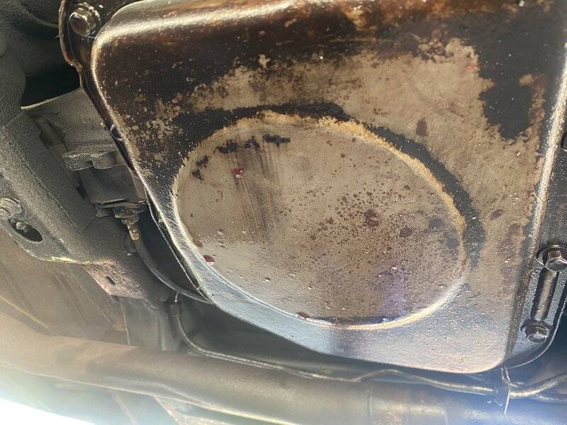

Really oh ok that’s interesting then the gasket kit I bought for a 904 didn’t fit. I’ll get a pic up here shortly. It’s a ‘66 Dart 270 Wagon. As far as I’m aware it’s all stock past the engine.
I think you’re right I do have a 904 which is what I thought at first so not sure why the gasket didn’t fit. Guess I’ll have to pull it out and again and get a different flex plate. Thank you for your help I would’ve never figured that out I’m new to the mopar world and everyone here I’ve talked to has been super helpful you guys are amazing thank you.
