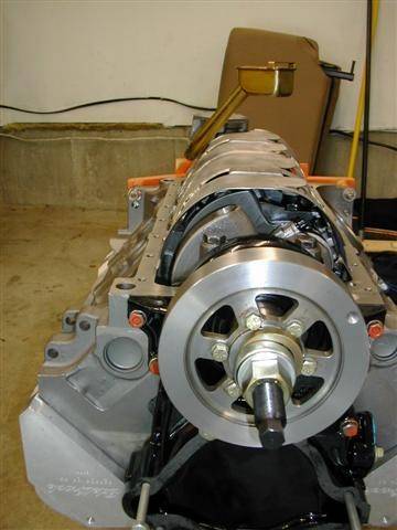

this pic don't show much, though if your eye's burnt out yet from old age or welding without a mask you can see the ground vents.
and yeah it's around an inch from the counter weight.

I'm sure that I read one recently where a member just fried his tray all over his crank. So it got me to thinking, I'd better have a good look at it.
Sure enough, it doesn't fit!
Seems to clear most rod ends except the rear most one. And I even had to grind down the pick-up tube, as it wasn't giving me enough clearance either.
Eagle crank and H-beam rods, Moroso pan and pick-up.
