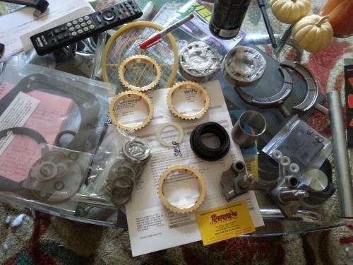

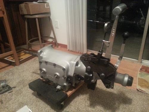

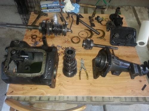

I have Jami Passing rebuilding the A833 book and it's very detailed with color pictures if you want some guidance. I didn't take near enough pics, but here is mine. I upgraded to an OD gearset.

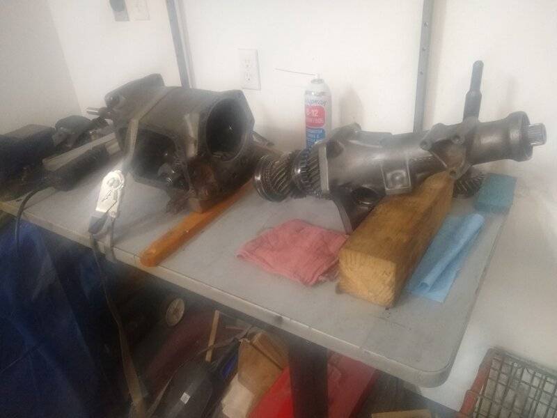

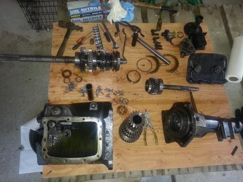

I had to dig deep to find pictures of when I rebuilt my transmission kind of out on the back patio of our old house...

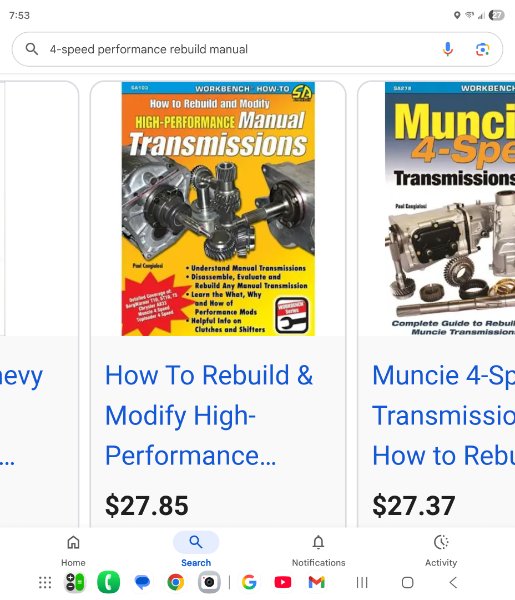

If you have any questions, post them, I have the book.I'll take a picture of it.... So you know which one is the best.. of course that's my opinion...
Give me a few hours and I'll go out.And take a picture of it and post it here for you.And if there's anything you need, just ask..

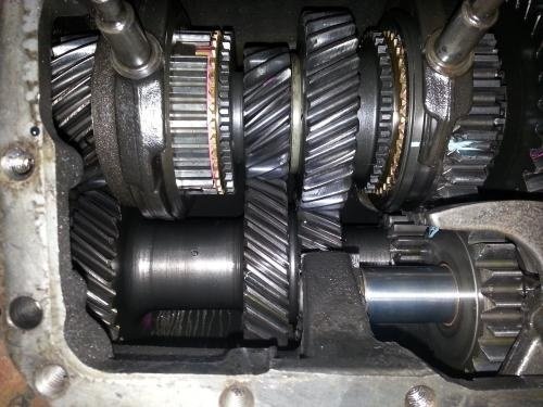

Now in that picture, I kind of went nuts and bought a bunch of extra stuff while I was in there, like putting steel shift forks instead of the brass ones.And I got new shifter levers, just so they were extra tight where they come out of the transmission and attach to the little ear... probably a lot of unnecessary stuff.But I was into wasting money at that time.I guess l o l...
Also, people talk about not having room.Obviously that's on a four by four or smaller.Sheet of plywood on top of a pallet on top of three chairs on my back patio... many years of drag racing with wrinkle walled slicks and slightly pulling the driver's side front tire off the ground... " after the first time I ever rebuilt one of these transmissions or ever seen the inside of it..."

That one covers almost all of the four speed transmissions, and gives tricks... Maybe later down the road, if you're wanting to do some fancy stuff..
But most importantly, your concerns were how to inspect, and he goes over that with pictures and everything...
