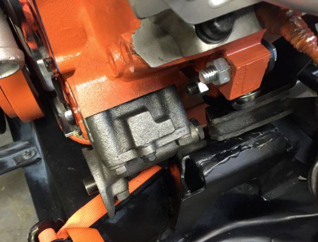

Is it a for sure thing that the K member must get notched for oil pump? Sounds like some have had to, and some have not.

I'm pretty sure you have to notch it for biscuit mounts and remove them for a engine plate.
I'm just cutting them off of mine & removing the pinch weld areas to reweld making room for the oilpan
Might have to on the '67-72 k-member. Easiest solution to a 73-76 V8 k-member is building a Direct Connection k-member copy.
This is a modified 6 cyl mount. Not sure if its the same?
