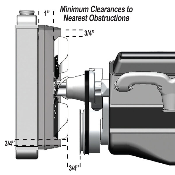

At a loss here... It was suggested to get the fan within 3/4 of an inch, it is now just that and now I'm being told it's too close and to either move the rad forward, or shorten the spacer. I do think it is a bit close myself. But if 3/4 is too close then why weren't there any objections before?
I'll be ordering another spacer today but what's the best size? Right now with a 2" spacer there's 3/4" between the fan blades and the rad. How much space should there be between the fan and blade?

It's probably an optical illusion of the way the camera captured the picture. If it is 3/4" you are good.

I use (and have used) a few Derale fans both fixed and clutch style. I go by what their instructions recommend for clearance. And it applies to any blade (flex fans excluded: wouldn’t use one if you paid me) made by anyone else. But, when you don’t have the room to put the blade at the ideal distance away from the radiator/shroud for whatever reason, you have to make sure everything else is up to snuff. No loose radiator or shroud mounts, clapped out motor/trans mounts, no fan blade with curled outwards blades, especially when needing to run it closer.
You have the room towards the engine. I’d find a spacer about 1/2” shorter if you in fact have 3/4” from blades and mounting bolts to the radiator.
I run a Hayden short clutch with a MP asymmetrical 5-blade. The clutch center fins are right at 1/2” away from the radiator, the blades are 1” away. My **** is tight. No issues with body flex or engine and trans moving forward. You got sloppy **** then best allow for that extra room as mentioned.

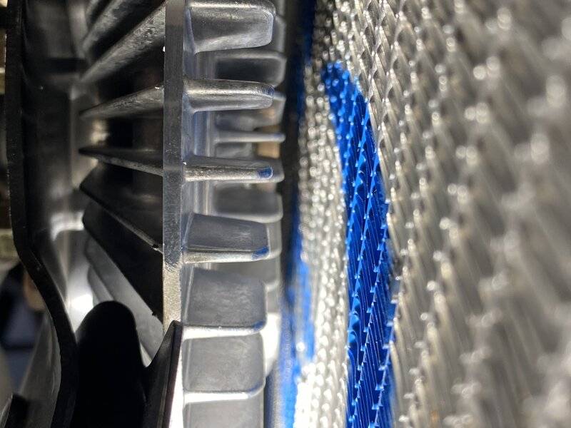

I can slide a piece of paper between the efan "bracket" and the rad, top to bottom, however at the top of the rad the fan is a bit more than 3/4" at the bottom of the rad it squeezes down to 1/2" clearance....
