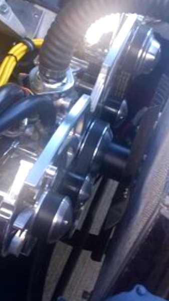

I installed the fresh air intake, what's the thoughts on this? Maybe a better looking hose, or just not at all?

It's close, but not too close. I did order another fan, a flex fan, but won't be until next week:(
Maybe it's an optical conclusion, but that fan looks really close to the rad in that last picture.

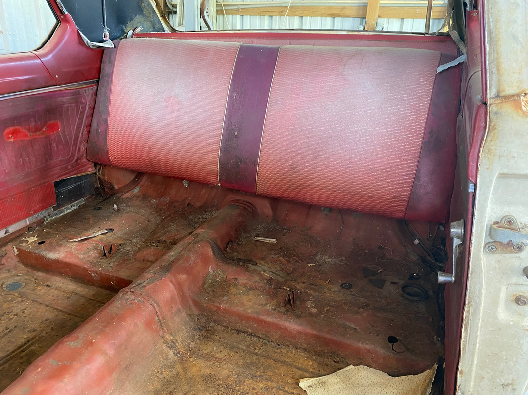

I had bought these seats a long time ago for the front, but they have some flaws, but might be ok for the rear. This is my grand daughter, she's almost as tall as me! with decent backing, carpet, maybe a mini console? thoughts~
The are recliner type, forward and back

With the kids gone, I had a little time to play mockup;) This is going to work. As for a console, the cardboard is 4.5" wide, I might be able to squeeze 5". As I see it, the seats will rest on a sheet of 3/4 plywood(kind of what's underneath it right now). Perhaps dividing the seats from the trunk, a custom fitted sheet of 1/4 plywood covered with black carpet, but I do have black vinyl laying around here. Kind of excited, a bit different from the norm which I like :lol:

HI, I had one of the current fronts resting in the back not long ago, it's what kind of gave me the idea. The Miata seat just sits too tall, or it's headrest does. I had these "rear" seats and was either going to toss them, or use them. Keeping these will keep me from having to look for other options. It's rare that I have anyone ride in the backs of my classic cars, and rarely most people don't even look in the back seat area. That being said, these seats will be just fine;)
Can you put a set of buckets that match the front in the rear?

Gee a while back I suggested 4 bucket seats and look what you did just messing around . Looks great
Hmm if I wanted to I have 2 beaten up Barracuda bucket seats that will need everything to make them match the front buckets and that would be spendy . Besides I already have the rear seat recovered .
So if I got the motivation and just wanted to see what 4 matching seats would look like I might just mock them up someday . Yah right !
