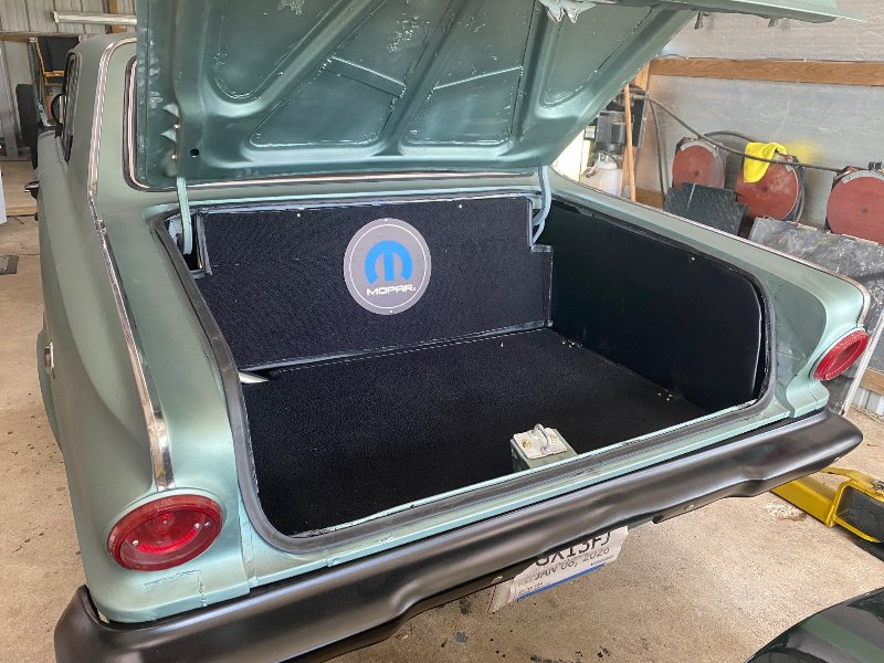

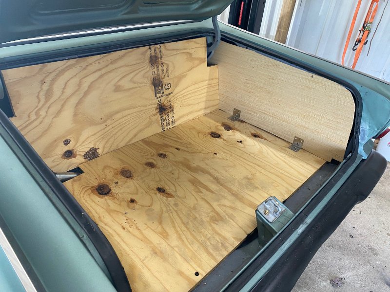

put a little time into my trunk to make it more appealing;)

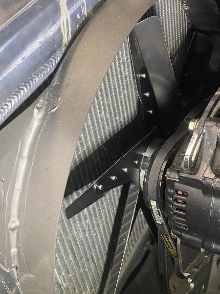

ok, took a longer drive this morning by myself, dang it runs great! however, when driving/moving along say 30-50ish, the temp stay 170-180, but when coming home and just 0 mph, the temp get up to 210-215 pretty quick AC on or off, doesn't seem to matter, but placing my squirrel cage blower directly into the radiator will be the temp down to 195 and stay there. It's only 80 degrees today. So, an 1) air flow problem? and/or look for a much better radiator? Just don't get stuck in traffic!

lots of 'modern' cars with ac have the engine's viscous/mechanical fan plus an electric fan that cuts in in time with the ac. maybe it's worth adding an electric 'pusher' fan switched by a water temp sensor in front of the radiator pack.

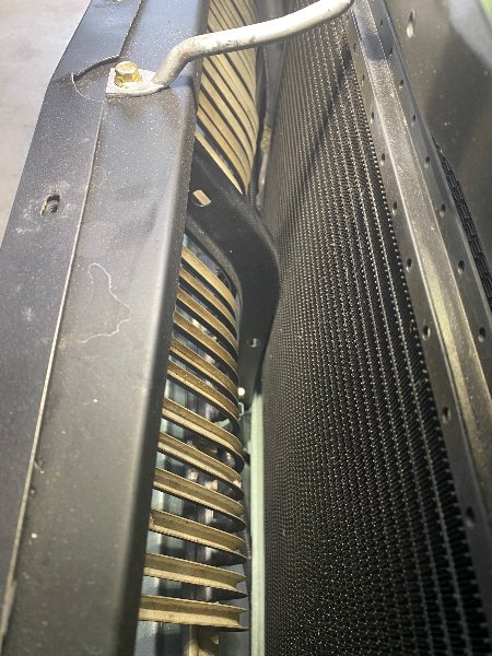

Unfortunately, the grill support is there, and just not enough room for a pusher fan. :( Maybe a puller electric fan? just always hated the noise of an electric fan

May sound crazy, but try it without the shroud.
Cooled a 440 with the same setup but No Shroud. Cooled just fine, traffic or not.
Those shroud corners may just be holding the air flow back. If it's open air can flow through.
440 ^ no shroud, going on 5 years now still running cool.
Well, that's not a bad idea at all~ after lunch I'll remove it, it's a pita, but is something to try :thankyou: :thankyou: :thankyou:

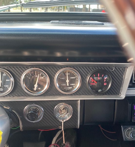

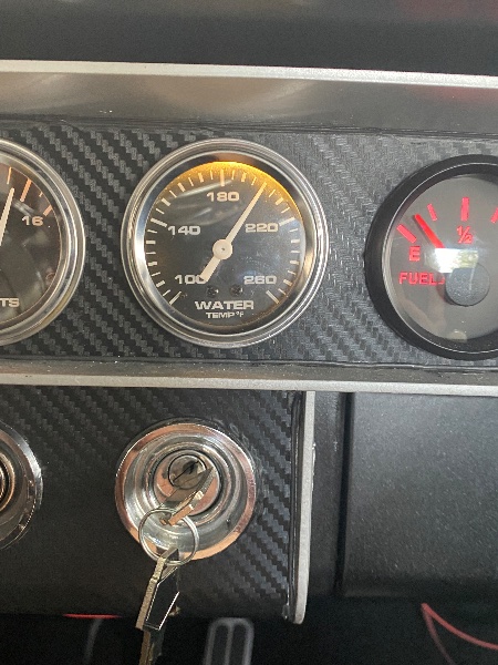

I’m never putting that shroud back in, arg, it was kind of warm(engine), takes a while to get up to temp, but even with the strong fan blowing, the temp crept up to what you see, ac wasn’t on.
Without the shroud in place, there is a lot of air , but don’t know if it’s being pulled through the radiator. So I closed the hood. Without the squirrel cage blowing, I think it would have gone higher in temp. It’s mid 80’s now.

hood closed with squirrel cage blowing into radiator, I also checked with my infrared and it's a little more than 200 directly onto the T housing, away from the exhaust manifold side.
my poor radiator:(
I’d say yes, funny that the T housing doesn’t really reflect the exhaust manifold temp, not too much anyway,

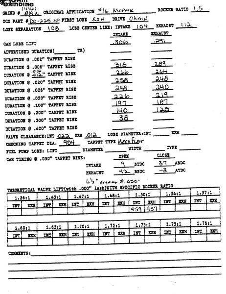

oh, I forget what I set the timing at, I thought it was 10 degrees, but I'll check tomorrow. I haven't pulled a plug since I started it, I'll recheck those too. Can valve adjustment do anything related to heat?
I feel I need to check the valve adjustment, never did quite understand the valve adjustment relating to the cam car below. Now that I have some time on the engine, maybe I should adjust the valves the normal way.

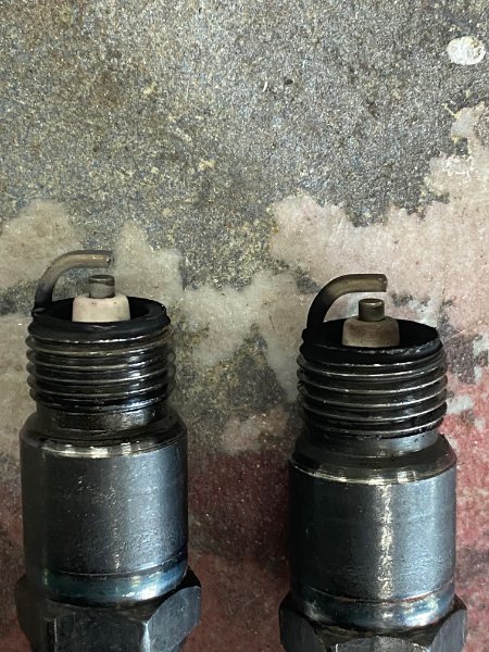

Checked the plugs tonight as the sun was setting after a run this afternoon with the '89 D100 318 4 bbl and Mopar HEI and E-Core coil.
Been 6 months since I last looked, figured they would be burning black by now. Nope, burning nice and clean, tailpipe clean too.
NGK GR4 plugs gapped at .050 ths timing set at 8° BTDC

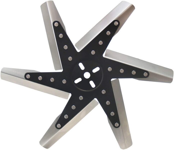

we used a wide blade flex fan on ashley's zephyr with an fe big block. he hot lapped all afternoon at the local 1/8 mile track with the motor idling all the time in the fire up road so no cool down between runs. it sat at 150 the whole time. his was a 19" big boy and he has a 3 row big block mopar aluminum radiator but still it was a hot weekend. when asked why he kept it running he said he needed to know it could handle being stuck in heavy traffic without overheating...... check :thumbsup:
neil.
ps it isn't anywhere near as noisy as we'd expected it to be, not as annoying as many modern 'efficient' electric fans for sure.
Belt-Driven Radiator Cooling Fans | Summit Racing
Thank you Neil;) Now to figure out what size fan to get. Now that I've kind of tossed the fan shroud, there's room for say an 18" or 19" :thumbsup:
i'd go with the biggest that'll fit. easy to check, just tape a bit of card to the end of one your current fan blades and spin it and trim it 'til it clears everything. more definitive than trying to measure clearances, it's how i do it anyway.

pulled a couple plugs, #3 and 5, look good. The engine actually runs very well.
