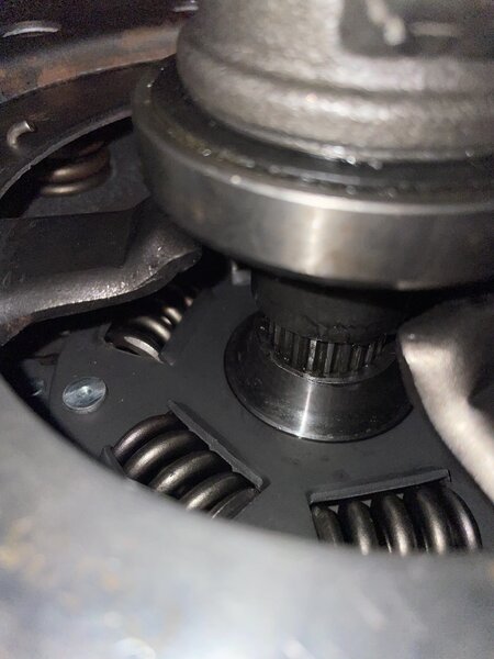

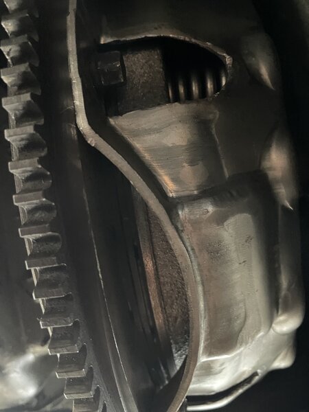

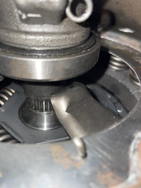

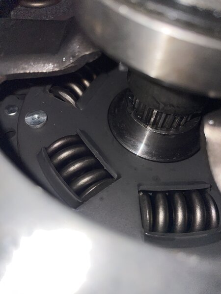

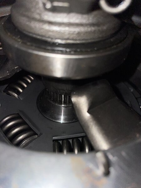

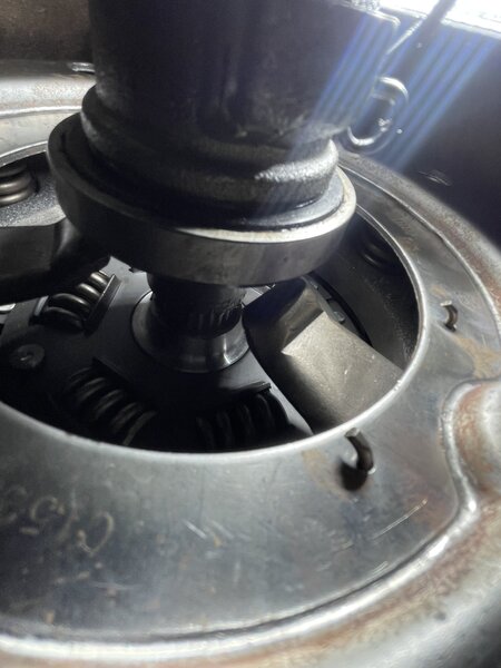

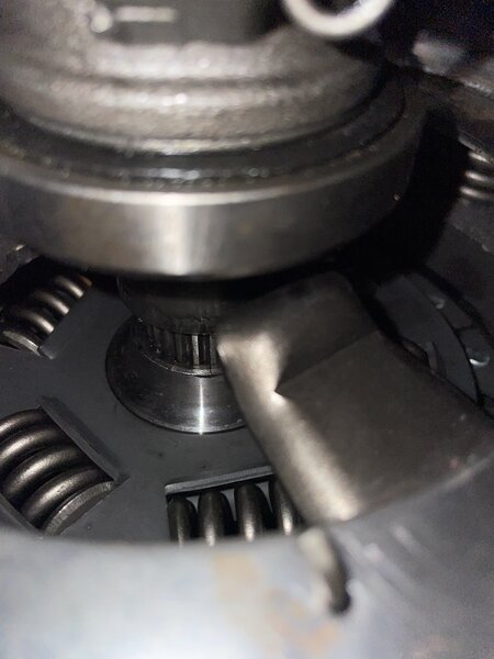

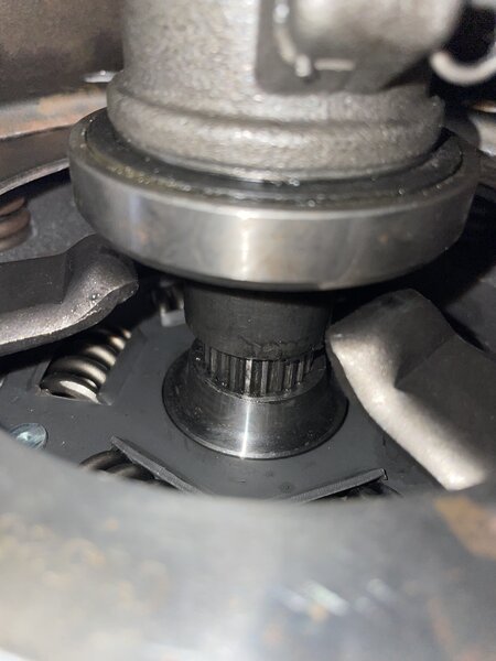

Well, I'd adjust the rod until there is -0- freeplay, then try it. If it's still no good, You're going to have to yank it, that's all there is to it...then some pics please.
Transmission side...
Engine side...
I can take a few pictures tomorrow morning and post on here if it helps
The offset spring-hub assy. goes towards the rear of the car, into the pressure-plate recess, NOT towards the flywheel recess & crank bolts.
Yes, flat part towards the flywheel. The hub towards the transmission. You should be able to see it through the inspection hole.
