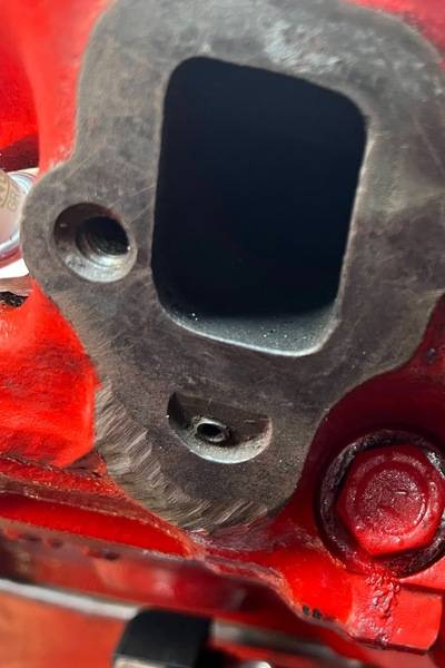

Good point! If his motor has heads that have the air bleed holes, the factory manifold hits the head under #7 cylinder exhaust port and won't seal up. Some are worse than others. The 302 heads on my 273 would probably crack the manifold if it were cranked down without grinding clearance. The Dougs D450's clear just fine!
or as simple as something like a loose or warped manifold...
Thanks for the advice, I'm gonna check the lifters when I have a moment. This engine swap is not going as planned at all, but at least I'm learning a lot (about small blocks) haha. It's been almost a year since the slant came out. The engine previously had late 60s exhaust manifolds on it, so the head was already ground down and I ground it a bit more, but I'll check the clearance again. It just doesn't sound like something like that, though. I have some '67 closed chamber 273 heads that I'd love to swap in, but those heads will probably need to go to a machine shop. Anyways, I hope I can figure this out soon and start daily driving the car again!
If this engine has solid lifters and adjustable rockers, I'd check all the valve clearance settings first. Of course if one is gapped too wide, it will be noisy. Keep an eye on the adjusting screws and make sure that they have the proper drag and are not loose fitting.
(From post 666, I see that your engine has non-adjustable rockers for hydraulic (not solid) lifters).
explain "the head was already ground down" please and thank you.
As you can see that pad under the exhaust port had already been ground down by a previous owner to clear the manifold. The engine was in a '68 Dart before and the manifold is a bit different. The early manifolds appear to need more room, so I ground it down more.
