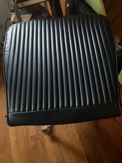

Completed passenger seat back

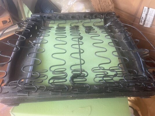

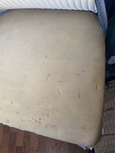

Before pic on the passenger seat cushion:

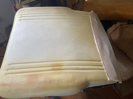

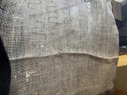

Passenger seat cushion stripped of the old foam, burlap and cover:

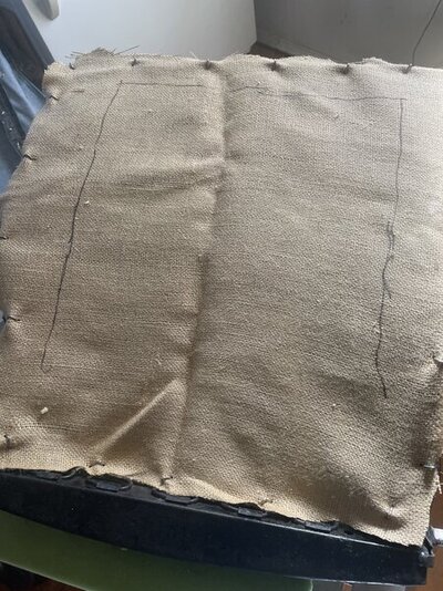

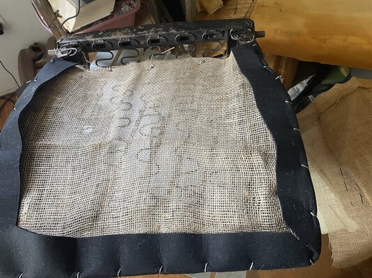

I got started on the seat cushion today. Where I left off
First, hog ring the burlap around the perimeter of the springs

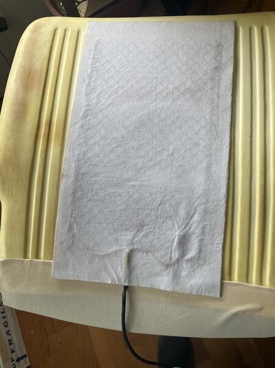

After gluing muslin at all 4 sides of the brand new Legendary seat foam, the foam was fitted to the prepared seat frame. The muslin was then hog ringed to the appropriate places on the seat frame - front, rear and sides.
Then added the cushion’s heated seat pad

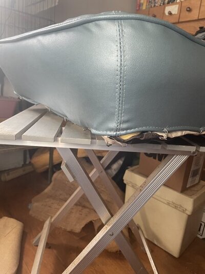

Then I spent the afternoon wrangling with the cover. I got 3 of the 4 corners mostly in place. Once I finally get the last cornersort of in place, I’ll work the erinkles out and hog ring it to the frame. Getting the cover over the foam is easier said than done. I tried Jerry’s @sgrip65 baby powder suggesstion and that was a no go. Legendary makes it look very easy - not in this amateur’s opinion

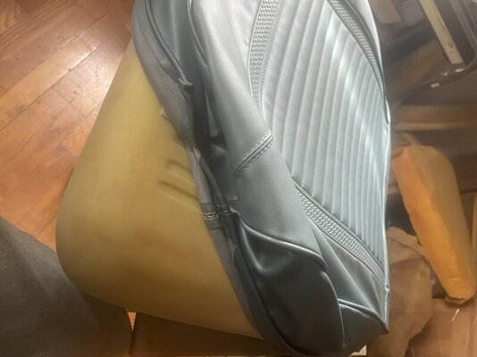

With a lot of tugging on the seat cover, pushing on the foam, having a 2nd pair of hands (my trusty helper - the wife), got the cover slowly pulled over the corner bit by bit until it was in place. Still had a lot of pulling on the cover to get it hog ringed on the back (5 hog rings), tunnel side (4 hog rigs), door side (3 hog rings and front (7 hog rings)! Other than painting the seat cushion side covers and seat back rear covers, the seats are 95% done.
Before:
After:

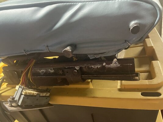

Passenger side tracks attached to the reupholstered seat cushion and power seat base attached to the driver’s seat frame. At least 10 years ago I prepped the power seat base to accept bolts through the seat frame. Yes, I knew way back then I was going to have a driver’s power seat.
I need to find a permanent Home for the controls - either in a side cover Hiding the tracks (which has to be done irregardless) or in the stock sest side cover. Since there is no seat adjuster bracket and knob, I will use the opening in that panel to house the controls for the power lumbar
