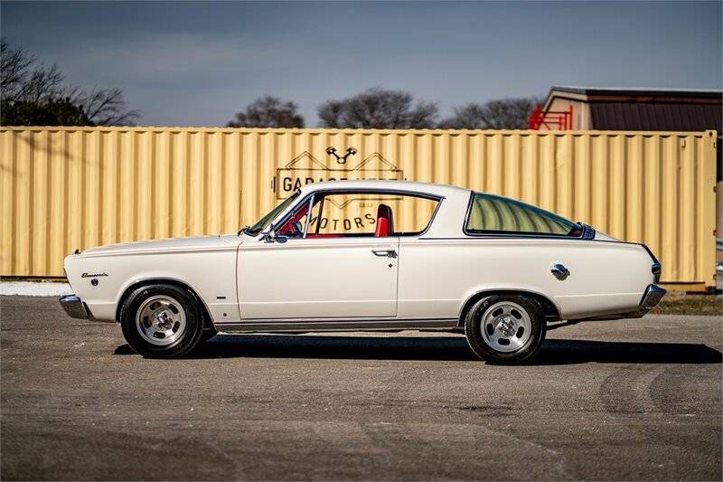

Do you have a side photo of yours? All of the ones I've seen that are in the stock location favor the front of the wheel arch slightly.

Mine could stand to go back a bit but not needed with the tires I have on now. These are 235/70-15's.

I would be very happy with that look/stance. What size are the fronts? What type rear end, and did you have to do anything superhuman to get those tires and wheels under it?
The front wheels are skinny 15x4 1/2, the rears are 15x7. Front tires are 165 80 15 and the rears are 235 70 15. Nothing needed, just jack it up and bolt them on.

Darn you guys, looks like you are correct. I'll check, but I know I was checking mine with wood dowels for outer and inner clearance. Pretty sure I checked the well for front and aft position also. I will try and check tomorrow. In the mean time here is a side shot. But I'm running shorter, handling high speed tires on 15 x 6 wheels.
