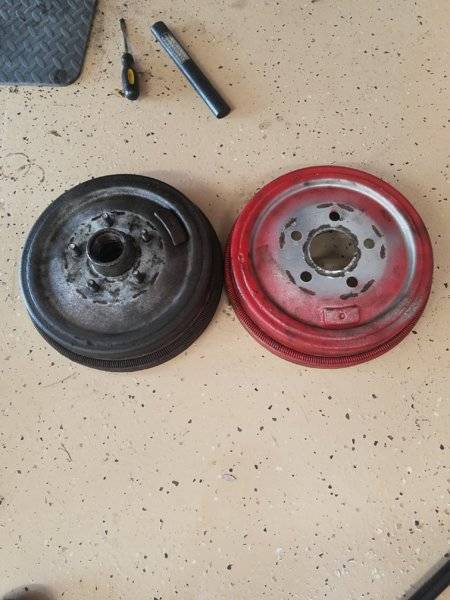

Just took off my front drums and see that the drivers side has the bearing housing attached but the passenger side has a typical drum with the bearings on the spindle. Which one is wrong?
the naked one has had the studs replaced and there is no swedge to keep the drum on. Thats a good thing as it can be worked easier. The loaded one still has the swedges on the studs. A swedge is a bulge in the stud, like the back of a rivet. Must be cut off.
But both work ok, and its ok to have a mismatch on the front? Is the one with the attached bearing housing just an older style or something?
The one with hub attached is how it came from the factory. As years go by and somebody separates the hub from the drum, they cannot be practically be "pressed" back together. Both are okay as Pishta says. If you plan on removing the studs from the pressed-on one, you CANNOT just hammer them out. There are many threads on this site on how to do it correctly.
Mine are the same as the black one. I was going to grind the swege (swelled area) off the studs, but I plan to replace with disc brakes soon, so I haven't messed with it. Basically, the factory studs had a swell to them to hold the drum onto the hub. You need to cut or grind that off to make the drum removable like the red one in your picture.
You don't want to drive them out of the hub without doing that because that swelled area will remove material from the hub as you are driving them out and holes for the new studs will be too large to press new studs into. Only option then is to weld the new studs back in, which many have had to do.
I've heard of people driving the hub out of the drum, then use a hole saw that has the right inside diameter to just cut off that swelled portion. The other option is to cut the old studs off flush to the face of the hub, then drive them out.
Ok, good deal. Actually Pishta didn't say if the mismatch was ok, but now I know it's ok to leave as is until I do some major changes to the front end. I really don't like how these old mopars drive at 70mph on bumpy Michigan highways..feels like I'm battling it. At 55 its fine though. All new front end parts, fresh alignment and all that but still sucks. Coil overs to come for sure.

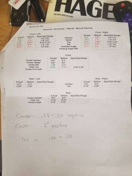

Thing is, these guys have old specs so I asked them to add more caster. The specs are what he did but I found specs on this site that you see hand written in the pic, that I'm going to see if they can do that.
What car do you have, and do you know the numbers it was aligned to? What size are your front tires, and do you have a stock setup? I have slightly thicker tie rod ends and sleeves and a brand new manual gear box and new upper and lower ball joints.

I see the issue. Looks like you have positive camber and negative caster. That's how the factory originally set them up for bias ply tires. With modern radials, you want negative camber and as much positive caster as you can get (within reason). I will attach what my alignment settings were, but there is also a thing floating around on here called a Skoche chart, that breaks it down by how you plan to drive the car.

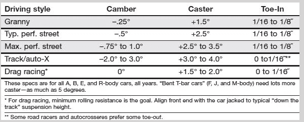

Found a copy of the chart I was talking about. My car has 225/60R14 tires on the front, stock setup, other than a faster ratio 20:1 steering box.
Something to consider,... alignment machines set toe by degrees, not a fractional measurement like 1/16" or 1/8". I calculated degrees for my diameter of tire and 1/16" is about .14 degrees. In my post above, you'll see they got my toe set to .14 and .13. Close enough for me.
You likely won't get 3 degrees of positive caster without offset bushings. I have them in mine and as you can see they got about 4.9 degrees of positive caster. Probably more than I needed, but I DID ask them to get as much as they could, and it drives well.

Yup, thats the chart I was referencing that I found on this site. I went a bit more with the granny, I just want a good driver, no road racer or anything. The chart I understand but your car print out is confusing.

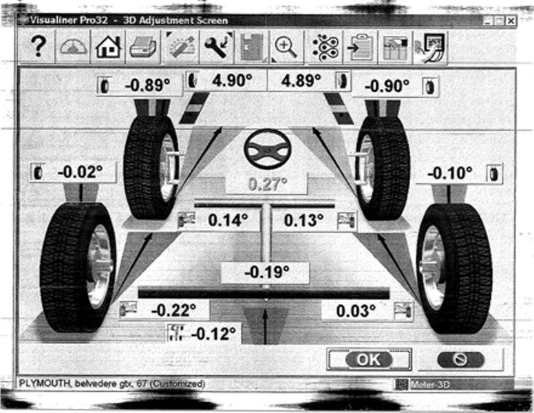

Yeah,... lot of information on there. Main points are the caster (+4.90 left, +4.89 right), Camber (-.89 left, -.90 right), Toe-in (.14 degrees left, .13 degrees left).
Steering wheel is off .27 degrees. Camber of rear wheels are -.02 degrees left and -.1 degrees right. Rear toe is -.22 degrees left and +.03 degrees right. That tells me my rear axle is not perfectly square to the car, but not off much. I think the -.19 degrees means the axle is shifted slightly to the left side from center. Not sure what the -.12 degrees is... Maybe the tilt of the axle that is causing the rear toe to be negative on one side and positive on the other.

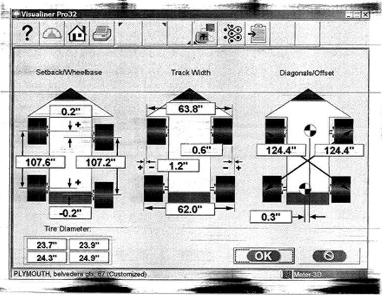

Not to confuse you, but they also gave me this screenshot printout after aligning. Kind of tells where everything is sitting from a squareness standpoint. FYI,... I am running P225/60r14 on the front and P245/60r14 in the back.
