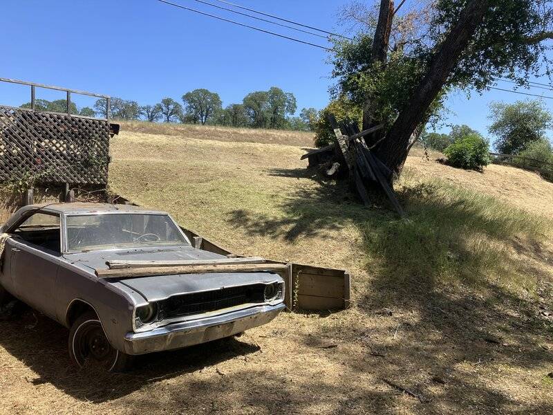

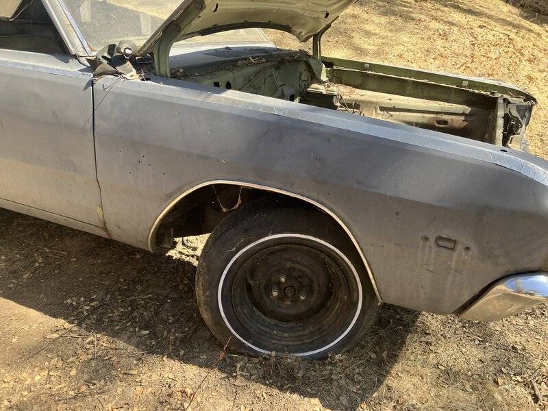

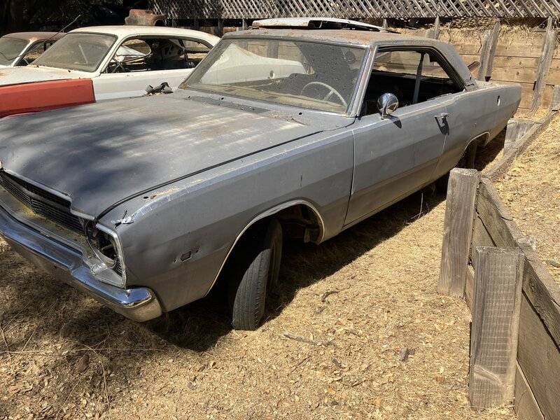

This Swinger looks different up close but for the time it will be onscreen, since it will be in motion and maybe a bit blurry, it will look close enough to my 67 Dart that it won’t matter. I’ll wash and scuff the black primer to darken it a bit to look closer in color.

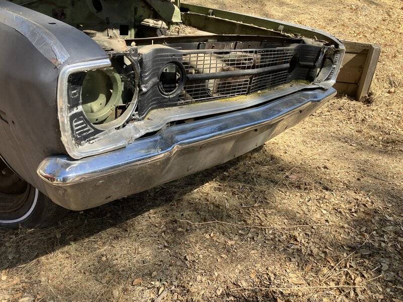

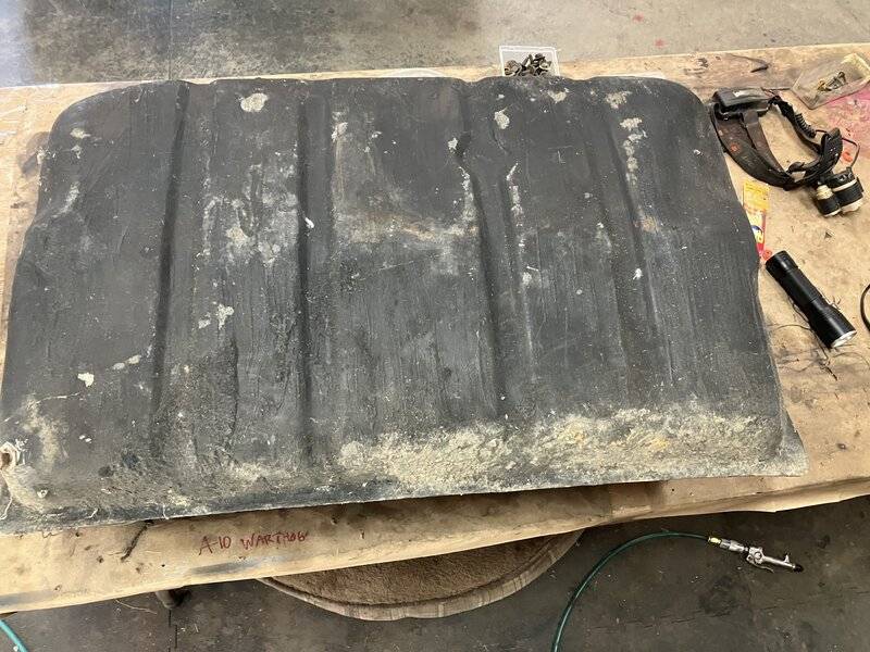

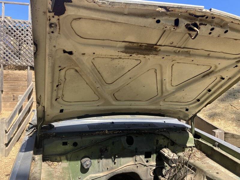

I’ll be careful to not damage this 67-69 hood. It is my only spare.

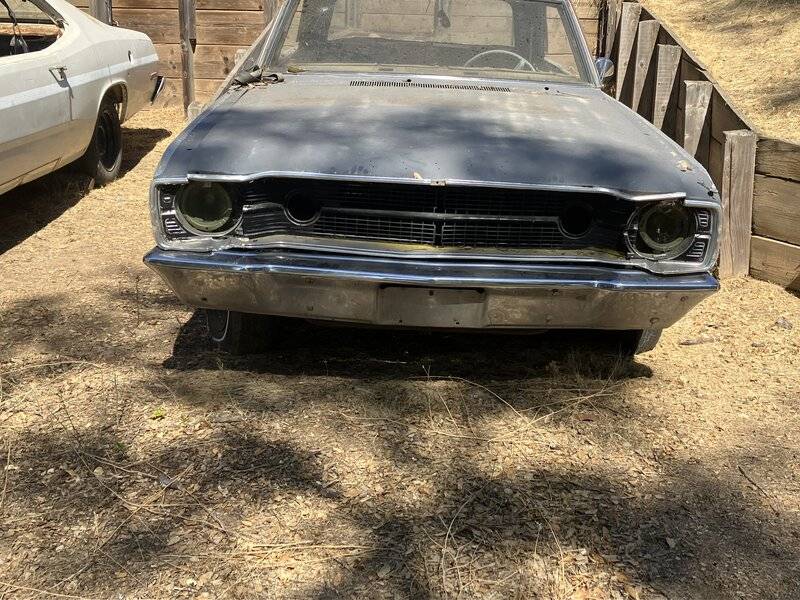

You can see the holes for the side marker lenses and emblems.

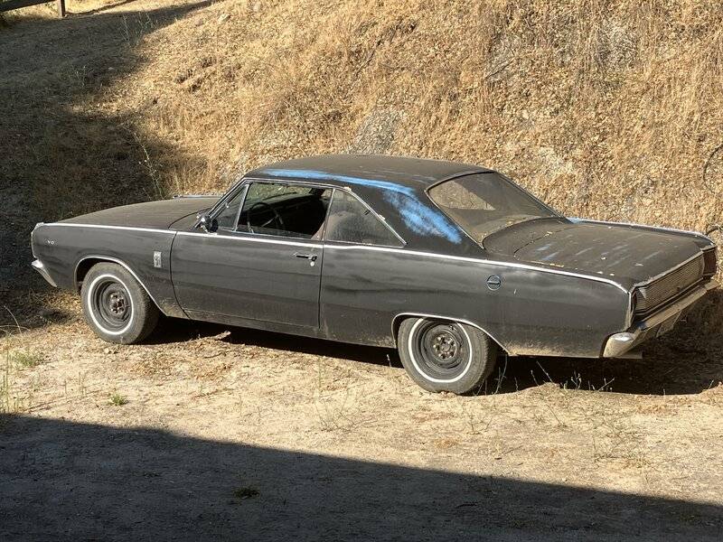

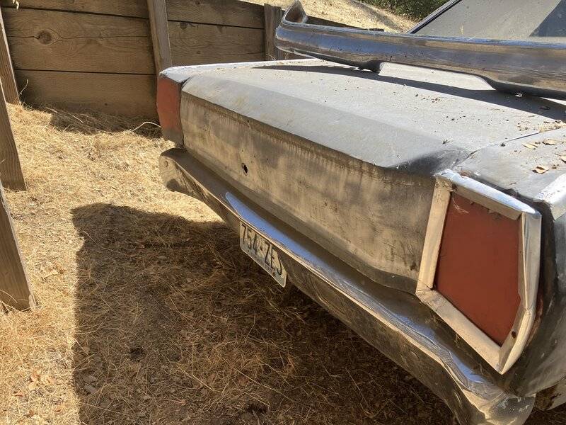

From here, at a quick glance it looks like a 67-69 Dart. I extended the quarter panels with sheet metal stock to fake the corners in.
The 70-76 Darts had that sloped top on the quarter panels. Looking closer you can spot the “fakery”.

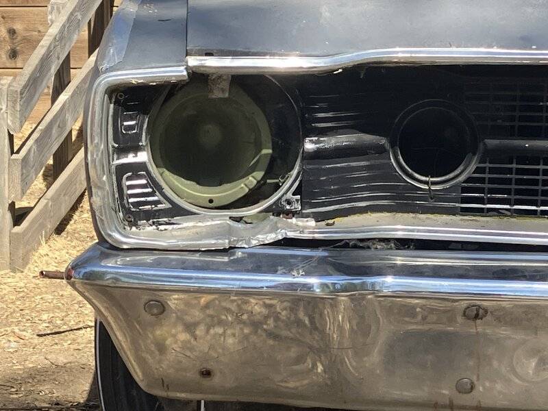

The fake bezel fell off the left side. I’ll fix that before the cameras roll.

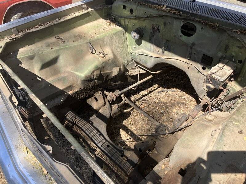

I pulled the fuel and vent lines out of that Stunt Dart. I obviously won’t need them there anymore.
I love
free.
That brake line was cleaned up a bit. I may have to change the fitting on the front of it. I’ll first disconnect the brake hose and see if fluid comes out the hard line. I’ve heard of hoses that collapse so I’m hoping the problem is there. The fuel and vent lines are 5/16” and 1/4”. I couldn’t expect the skinny 1/4” fuel line from the other car to be good enough since this car will have a 360.
