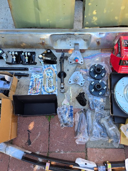

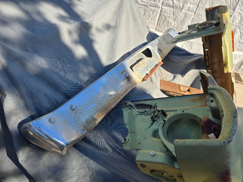

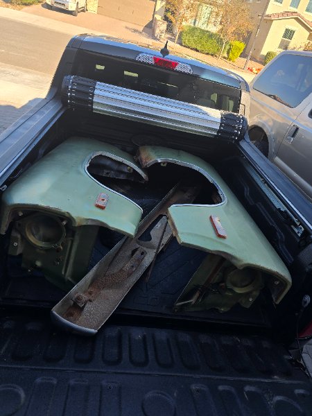

well went to arizona for the weekend to have some thanksgiving with friends out there. while i was out there i decided to look around for duster parts. found a guy literally next neighborhood over from my buddies i was stayin at who i guess parts out A bodies. went over and really nice dude let me look around. picked up a pair of decent front fenders, rear bumper and non woodgrain glove box for a decent price. while i was out there a bunch of stuff i ordered came in. still waiting on some other things.
Nice lot of parts there, just fitted my kaltracs with split mono leafs, looks like you went the calvert 9 way adjustables as well.
What brake kit is that? Any reason for the new spindels?
Is that a new steering shaft next to the u bolts
Was doing some googling and found a guy that makes brackets to bolt mustang brembos up to 73+ drum spindles or disc spindles but you'll have to get dr. diff hubs like i got.
Yes that's a new toyotaish shaft i bought to test to go with the sienna epas column i mounted. We'll see if I can get it to work.
O nice one, i just got my wilwood kit at great expence and running ford pbr rear calipers that i will rebuild. Interested to see what you do with the shaft i am just about to fit my new shaft to see if it fixes my pipe clearance issues.
Yep Dr Diff is great got all my spring offsets and multiple other parts from him. Waiting for him to get the special A body booster brackets in stock so brake booster clears the valve cover
nice. yeah i gotta figure out a booster. guess i should wait and see what they come up with.
