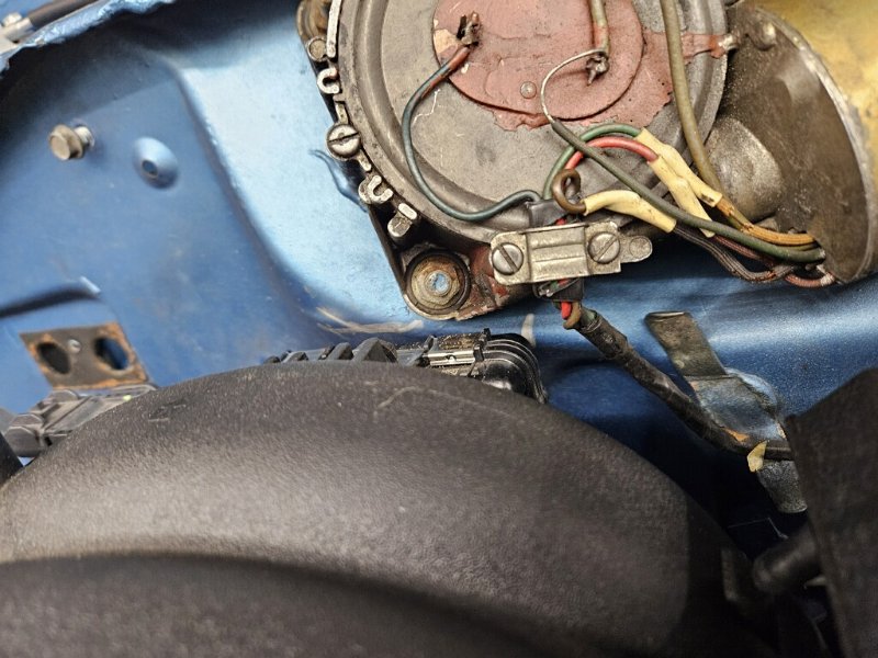

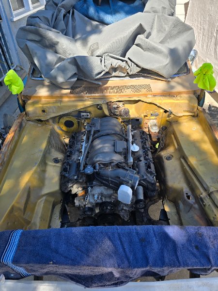

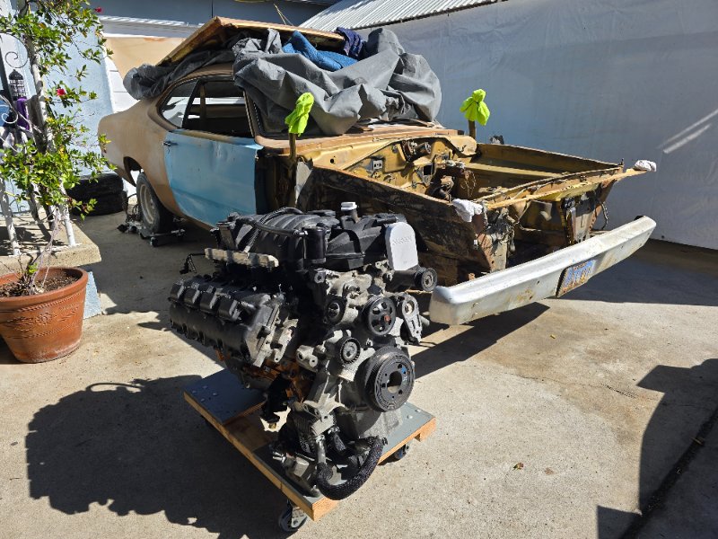

so swapped oil pans and test fit the motor today. didnt have the trans bolted up. man thats a tight fit. i dunno if its cause im using a 6 banger k member with the schumacher mounts or what but man i dunno what kinda headers are gonna fit besides the log style. i will be goin coil over up front so not gonna have the torsion bars. also i guess i need to do the runner flap thing delete cause that thing was not fitting with the wiper motor. unless theres a different wiper motor people swap to? besides that gotta start cutting up stuff now.
I have a 6.4 in a 69 Dart on a /6 k member and Schumacher mounts. My TTi shorties fit perfect. Same car, with a 5.7 mock up at one point and TTi long tubes also fit great. Not one ding needed anywhere.

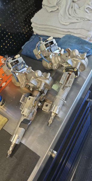

havent got to do much lately between weather, getting sick and plans with friends. i did paint the front inner fender wells with some eastwood stuff. after i finally finished welding and seam sealing the driver side floor i took a look at the passenger side cause i thought there wasnt any rust so i thought about not replacing those but i did find a few holes so decided to start cutting those out. also gave me access to weld the top of the passenger side subframe connector. i need to figure out a trans mount. debating on buying or building. i grabbed 2 toyota sienna epas columns that were getting thrown out at work to see if i can do anything with those.

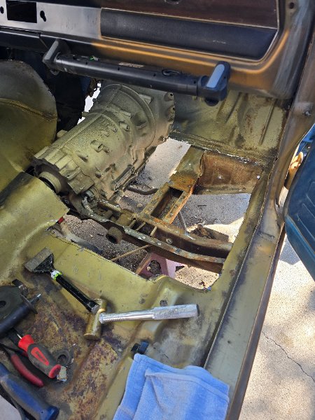

i was looking at that one but dont see it on his site. man i kinda wish it test fit the motor and trans first instead of just cutting the tunnel out as much as i did. oh well. live and learn.
Call Denny or send him an email if your interested.
Looks like you did not have to cut that much from the trans tunnel...
I have motor mounts that move the engine approximately 1" forward and the Hemi Denny trans mount, both are relatively new. I couldn't find any advice on how much tunnel cutting would be necessary other than Denny saying cutting was minor. I have a close friend who back halves cars on a regular basis and that's minor for him so I decided to wait until installation to find out what minor was:). Before installation a lot of protrusions on the transmission that are not used with MOPARs were removed. Upon installation the trans was pushed up until it contacted the tunnel. With that I could determine what to remove. With the tunnel removed most of the mount could be installed but the hoop required some vertical cuts. Once the new tunnel is rolled the original tunnel will be cut a little lower than it is now. All in all this is a lot less than some of the nightmare stories I've heard.
ah so you trimmed off all those little extension things hanging off the side of the trans? theres soo many and some stick out kinda far. i might have to trim some of those off too. im either goin to buy a universal tunnel kit or i was kinda thinking of getting some steel rods and shape out how i want the tunnel then fill in the spots with some 16g steel plate.
