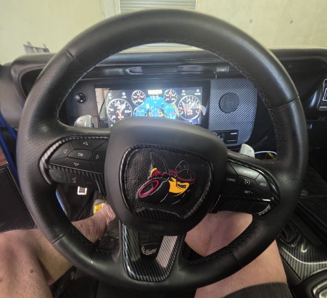

I cut the centre out of an old dodge wheel & machined it to fit a scat pack wheel still have to make a circuit board for the clock spring so i can use the paddle wheel shifters with the sound German controller & maybe blank off some of the extra controls currently i am selecting performance & track mode with the digital dash switches but i will make a plate the for the square gear indicator with a 3 position rotary switch beside it. Also had to remove the airbag & a pic of my modified steering coupler off a Landcruiser
Please elaborate on the steering wheel swap. Did you keep the stock A-Body column?
B Body the column is stock at the engine end there was a weld so i machined that off & used a slide hammer to pull the short end shaft out the strange thing was the Dodge spline in the hollow shaft is the exactly same as a Toyota spline from 50 years later also the Borgenson was originally a Nissan or Toyota box Borgenson modified on the 1st edition so i knocked the shaft back in & tig welded it passed the inspection by the DOT engineer i did not take pics as i made it more of if it fits it fits.
