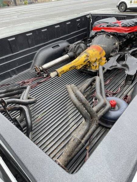

Welp im knee deep in it now. Long day. Got a bunch of stuff for the swap, drove about 5 hours to get it all. Yanked the 6 & 904
Picked up the 360 LA, came with electronic distributor which is great cuz I have a blue ecu control box and harness.
Picked up the 727 and torque converter
Also asked if he had some a-body headers and he said yes - sold them to me for 200 extra - they retail for 900+ headman I think.
Also he threw in a free k member and manual steering box so now I can either return the shumachers slant 6 k frame adapters and use this or sell that k frame

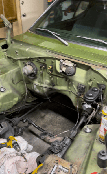

I take it back. I didn't even look at the K-frame when I tossed it in the truck, but im pretty sure there's something missing... lol
well, there's one thing you don't have to worry about.
Wow. Looks like they even took the idler mount off. Seems like it would be a ton of work to just replicate the idler mount brackets. Motor mounts could be an elephant ear deal or completely custom, but without the idler the steering would be a real pain to figure out. Pretty much junk if you ask me.
you mean primed for a rack conversion, right? right?
hey! wait! where are you going?!? c'mon man... come back!

Slowly getting progress here and there.
  • Wiring out
  • A/C Components out
  • Degreasing started
Next up, once it's all degreased going to start sanding down the bay and prepping it for paint.

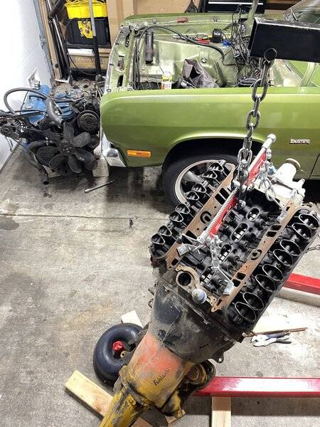

Engine is on a motor stand now, so need to start pulling the heads off and pan to see what's up there.
Pulled the driver side head off tonight because i wanted to see the condition of things. Since its my first rebuild maybe you guys can tell if theres anything off or alarming. Just seems dirty and needing some love.
