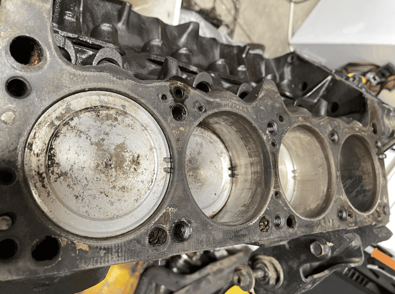

Thats awesome! yeah always can rip the engine out and worry about that later. This was meant to be a budget swap for me. Have you seen or tried those hone tools that deglaze cylinder walls?
Amazon has one like this that I might try. My cylinder walls are pretty shiney and a bit of surface imperfections. Figure the price might mean it's worth a shot. I heard a trick of putting waxed string around the gap of the piston to keep the small metal bits out, then just vacuum out the junk and wipe it down with wd40.
Hone deglaze tool

3) deglaze the cylinders and clean

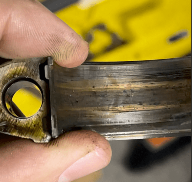

the bearings are gonna tell the tale of the tape.
i wouldn't clean jack **** till i popped the caps and made sure i wasn't dealing with core.
then if it's runnable i'd formulate a plan of attack.
Yeah you're spot on. No use acid flushing my waterjackets if the block is trash lol. My rookie engine builder is showing through. It would be one thing if I had bought an engine that I had heard running, but with this thing it's a guess until I see.

Im no expert but these are the connecting rod bearings off cylinder 1 & 2. Look pretty worn but no damage to the crank (so far). Rings don't look too bad though.
Pulling the rest of the pistons out later tonight and then I'll check to see how the crank mains look after that.

looks like plenty of debri has gone through the oiling system. i'd at least check if not replace the oil pump too. plenty of oil and filter changes are needed once it's running again. that's assuming you don't do a full strip with a comprehensive block cleaning of course.
