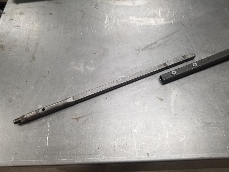

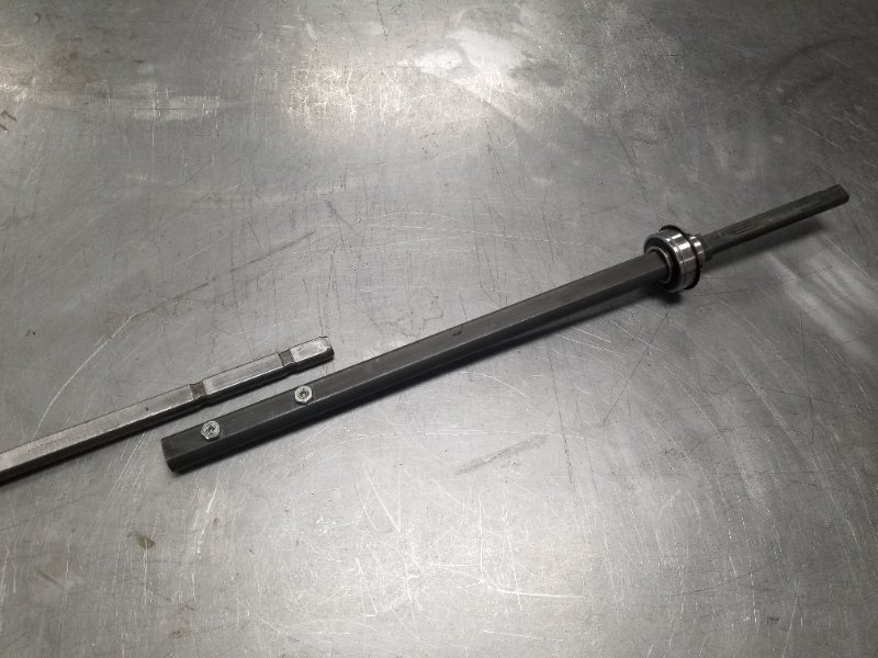

simple mod for more space and ease install / removal.
HDK replaces the lower portion of the 2-piece shaft with a piece of 1" DD that is held solidly in place by two set screws and a new sturdy bearing. No longer a need to loosen the column once in place
lower section of 3/4" DD slips into the 1" DD and cut with approx 2-2-1/2" into the 1"'DD. The 3/4'' DD shaft will slide easily in / out but is held securely into the 1"DD
use a Borgeson vibration dampener / u-joint to connect to the 3/4" DD shaft to the OEM shaft spline.
the shaft size is now 3/4" solid vs the OEM hollow 1-1/8 od and makes install or taking off or completely out a breeze.

The idea being that the lower portion becomes the collapsible section in the event of an accident? Or do the upper set screws still slide some if something bad happens?
That's easier than trying to weld the larger slip tube to the stock shaft for sure.
The idea being that the lower portion becomes the collapsible section in the event of an accident.....and it makes it super easy to install and remove the lower section without disturbing the upper.

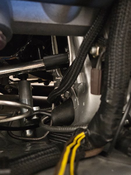

O hhaha i just realised you are HDK, i literally sent you an email asking about it. Pics would be much appreciated! As currently the cuppler is clashing with my pipes

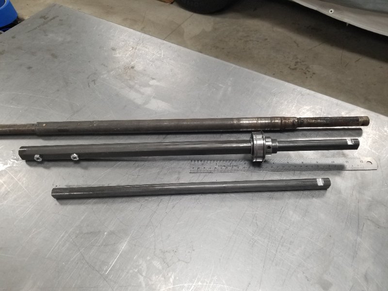

The shaft to the u-joint or vibration dampener is now 3 pieces
1)OEM upper
2)HDK 1" DD intermediate (cut to length)
Those stay solidly in the car.
3) HDK lower shaft the slides into 1" and attachesto the u-joint or on an OEM application, the vibration dampener. Because it can slip upward, this section is easily removable
Comes with bearing for your cut down 2" id column.
Pictured is my first version , the bearing is recessed. Just the 1" (black) is protruding into the engine compartment.

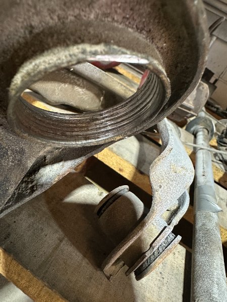

The threads looked funny and yep, removing the upper balljoint has cooked the threads, needed a 6ft bar extension to undo them.
Tried a new upper bush in and just drops through the thread.
Not sure if thats a common thing to happen undoing a upper bush
See in the pic that the threads have lost their teeth. Think ill just get new Dr Diff pressed ones as the engineer isnt a fan of tubular as they are not rated and have mixed reviews from people in the know
They never had properly formed teeth. The idea was to make the thread an interference fit so that they did not loosen up from the pounding they got in operation.

That thread look's about normal ,when i pressed the new rbber bushes in it took about 1 ton on the press.If they are too loose they will turn in the arm also make sure the arm is loaded before tightening the adjuster bolts & the lower main support pin
