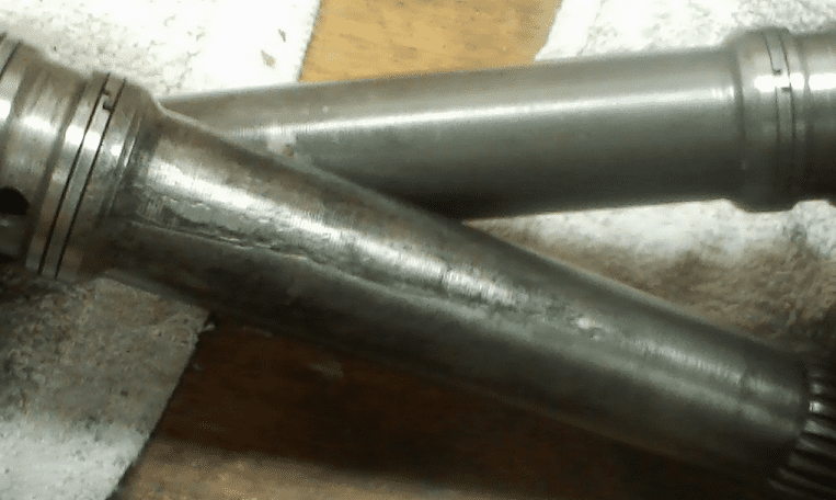

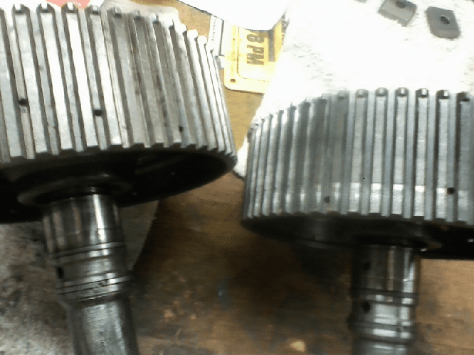

I cleaned up the rusty input shaft best I could. Do you think this pitted area warrants swapping shafts with the other one I've got??? Will this hold up to 600-650 hp? Keep in mind the hub on the clean shaft has the messed up clutch splines. Is it worth swapping the good shaft with the good hub?
That rusted shaft looks like it has a manufacturing flaw to me and it looks twisted.
I would not use it. Ideally another shaft would be best but if the choice is one of the two, I would use the one with the slight wear on the spline. It's not ideal but it probable will run fine. You could probably use a smooth honing stone and smooth down the marks or any burrs. IMHO
How strong is the press fit on those input shaft/hub assemblies? Is it something I can get done with a 12 ton press?

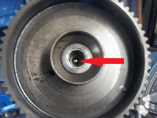

Stupid question - Any idea what the small ball at rear end of the input shaft is for - the end for the output shaft pilot?

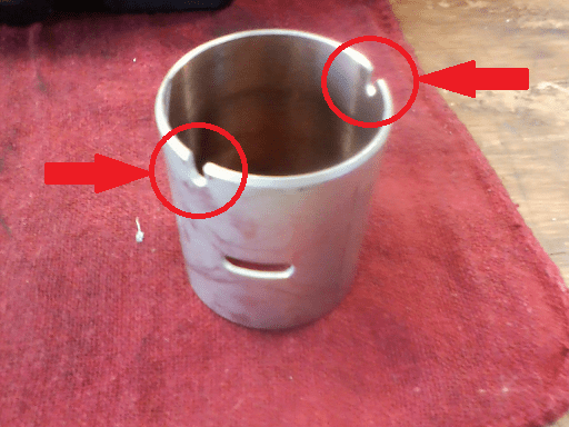

While installing the bushings, one question came up, I noticed the new tailshaft bushing has two notches on one end. I realize the hole in the middle has to line up with the oiling notch in the extension housing. Does it matter how the notches are oriented (towards the rear or front of the trans)?

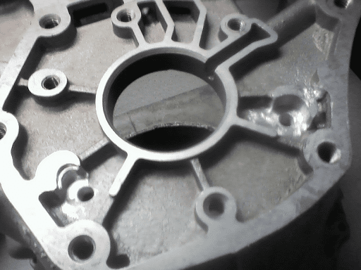

Another minor victory today - With some creative grinding and my drill press, I was able to clearance and drill the case to use all 6 bolts on the Ultimate sprag. No costly jig necessary. On to assembly...
