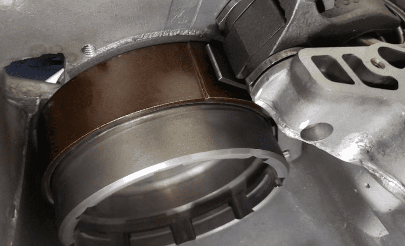

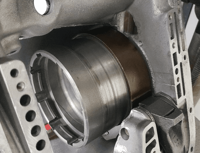

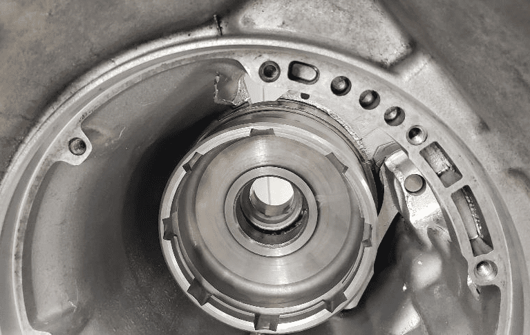

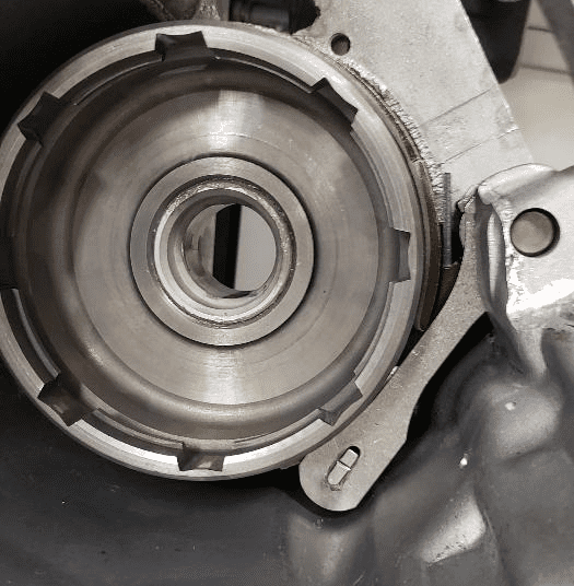

Alright guys, I had a few minutes to mess around with this thing today and had a minor setback. I went to install the rear band and drum and I can get the rear band strut it. I can without the drum in place (barely), but then the drum won't fit. The only non-stock pieces I've got are the band and the billet rear servo. The strut is stock (I believe) and measures 1.32". Is it common to have to take .25" off the stock strut to make it fit? Otherwise, could I have the assembly installed wrong? Could I have received the wrong band?
Thanks a lot. I know these are stupid questions.
Make sure the top of the band is locked into the strut strap and back off the adjuster completely. Then put the drum in. Did you replace the o-ring on the servo lever shaft?
Thank you. I tried that as well and it's too snug to install the drum. Top picture is with the strut installed and screw completely taken out. Looks like the strut need a slight shave. Is this common???
Yes, the shaft has a new o-ring.
Like I said, make sure the top of the band is locked into the strut strap. Did you compare all the new parts to the old? There were changes thru the years.
Everything is fully seated. I discovered the problem though. The new band has thicker lugs - by about 3/16" per side. Apparently, I need one with narrower lugs. The company I bought the bands from is sending the correct one.
It's weird that Chrysler would use two different versions for the same yr, according the trans company the bands came from. Sounds like the narrow lug versions are an oddity, but not uncommon. I can only assume the strut is longer than the ones used with the more common large lug version. Otherwise, I'd find it hard to believe that Chrysler would make two different length linkage arms. Oh well, at least the problem is being fixed.
Running changes are common in all automatics; many have several different variations out there at the same time. Folks bring me several transs and want me to put all the best parts into one; not always doable.
It's amazing how much easier things go together with the right parts. TSR 2nd day'd the correct band to me and it fits just like it should. Got the gear train/output shaft installed. Almost there!
Here's a picture of the small difference in lugs. The difference is only ~3/16" per side, but it's enough to mean the difference between working and not working. I'm still thinking shortening the strut would have worked.
