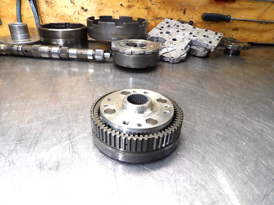

This was the planetary set I was looking at. It's got the same 28 tooth spline count on the inside as the one that I took off. I know that my unit is a '78. Is that the spline that you are referring to?
They both have the same spline count. 76 and newer has a bigger hole in the planetaries and the shaft has bigger splines. So u can’t slide smaller planets on to the bigger shaft splines. But u can’t slide smaller slide bigger planets on to the smaller splines. That is a no no. Find out from the seller what year his planets are.
Just sent them a message. Hopefully they can just get me a a measurement of the hole diameter, and I'll check what my planetary gear is here and it'll match up.

I'm not going to knowingly rebuild a transmission with broken parts. I'd like longevity and to not have to rebuild it in 10,000 miles. The planetary gear assembly is cracked to the point I could break it with my pinky. If the guy who wrote one of the definitive books on these transmissions is recommending I replace a part, I'm going to at least consider it. A correct drum is $60, hardly something that'll break the bank.

just because it came apart that way doesn't mean it should go back together that way.
repeating poor, or questionable work is bad practice.
these cars are old and anything could've been been monkey'd about with them by any hackasaurous wrex from planet hackulon in their or our lifetime; so just blowing something apart and going: huh, welp, i guess that's how it is and knocking it back together might not always be the best play if the dude that had his grubby mitts in there before you was a sloppy joe or finger tight jimmy.
trust, but verify. always.
and also, if the dude that wrote the damn book on 'em is saying stuff is wack and to change it out, then it would probably be wise to take his advice.
