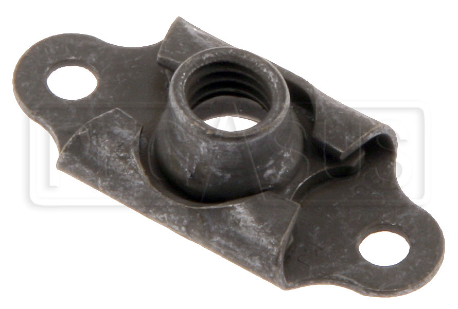

Hey Ross,
The dash is freakin awesome. What type of hardware did you use to mount it to the dash? Pen nuts? Sheet metal screws? Just curious.
Thanks
Hey Ross,
Thanks
Thanks for the Compliment...I used floating nut plates in the dash frame and Black Oxide Flat Socket Cap screws counter sunk into the gauge panel that holds the two pieces together.

do you have a pic of a floating nut plate thx
The nice thing is that the "Floating" nut will move around inside it's cage and give you some free play if your holes don't perfectly line up. The two non threaded holes are for rivets that hold them to the panel you want to attach the nut plate to.
Where can you buy those floating nut plates. I have no use for them right now, but can see them as being useful in the future.

There usually used in the Aerospace industry but there are several sources online that sell them...just search for "floating nut plates".
