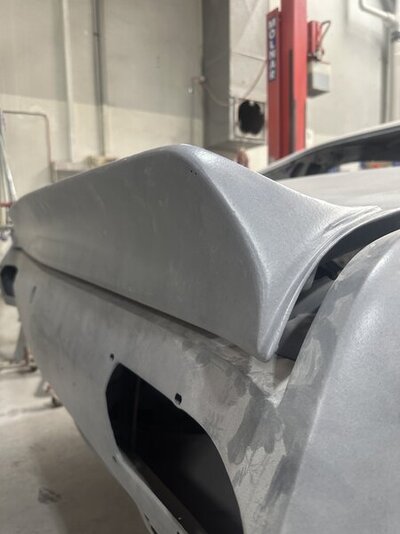

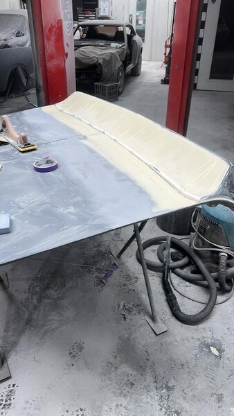

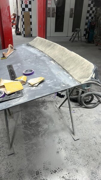

So the duck tail is taking shape, have built the thickness of the tail up to then trim to get a more even leading edge thickness as was all over the place.
Then have bogged the face to get rid of the highs and lows, i am super super anal with panel on my cars. My other projects have always had show stopping panel and paint. I want this car to really stand out from a crowd, but tastefully modified etc.

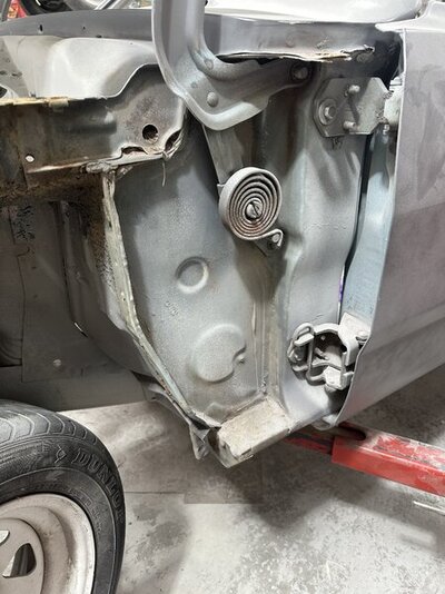

Currently have taken the front guards off and prepped all the underside of guards for paint. My chassis stiffening is in the mail from interstate as the Australian chargers have same floor pan. So looking forward to getting that welded in so i can lay colour mixed Raptor liner on the under side of the car.
My diff is all built just waiting to cut it down to length which he will do with the car in his shop. Still tossing up on if to run wilwoods on the rear otherwise ill use Australian Ford disk brakes as same stud patern as mopar. Just run wilwood on the front. Due to running a newer motor and needing engineering my car has a brake test so not sure the standard brakes would pass the testing

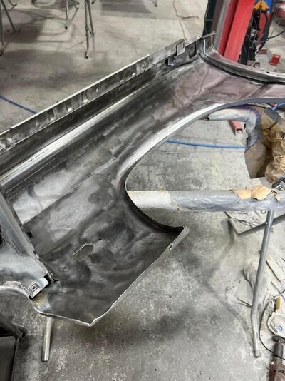

So lucky with this car, pulled the front guards off and zero rust behind them. Remember this car was a beater when i got it wasnt even drivable and never had a resto other than very bad crash repairs. I was expecting rust in this area for sure. Pretty much in factory condition, lot of sand blasting dust in there so good to remove that as have been sucking and blowing it from every hole in the car.
Back of guards to bare metal, acid wash and prime. Not sure if the guards had been off before, was odd as when bolts removed looked like the guards were glued on to the body with some kind of polyurethane. We are also re seam sealing the entire car as obviously its all been removed and also gone super brittle

I really rate it, changes the whole look, especially as want a pro street look etc as running the wheels in my profile pic. Not everyone will like it.

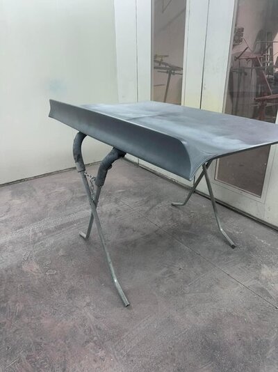

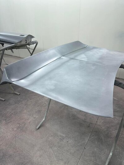

The duck tail took quite a lot of work as has a lot of lumps and bumps in it, also took a lot of work to get the edges of it even as they were all different thicknesses etc. We decided to finish the lower section flush with the trunk lid, some people run a shadow line along here like the camaro but the casting was not even close to straight so easier to blend it in than try recreate a straight line etc if that makes sense
You can see here we kept a 3mm shadow line down the sides but as i said not one along the bottom. I probably would have prefered a shadow line but was easier this way.

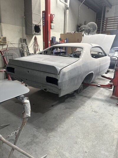

Body work all completed and ready for paint! Has a few small areas that just need a little bit of love, very minor couple panel gaps i want perfect that most likely just a bad factory gap. Loving the look of the ducktail it transforms the rear of the car. I will also start work on the rear bumper conversion and compressing the front bumper mounts, removing metal etc

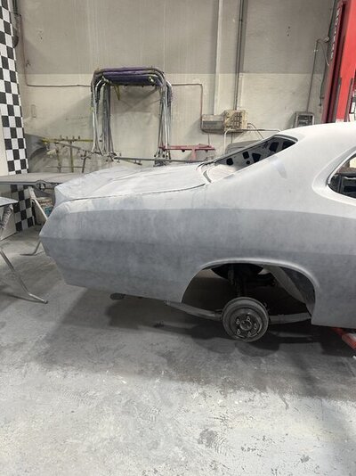

Couldn't resist and put one of the rear wheels on, actually fitted, however the diff is going to be cut down so the whole tyre fits in the fender. Currently very close but i dont like the look where the tyre hangs out, a bit old school for me.
You can see in the 2nd image the way it is i cant tuck once lowered. I have about half an inch to the leaf spring so with the offsets will have nearly an inch i can shorten the diff to get a perfect fit.

Like you, willing to slightly narrow the rear to keep the wheels / tires tucked in. 275/60/15 on 8" rim with 4" backspacing. Cut the housing down a total of 1" and took 1/2" off each axle, Dr.Diff off set hangers on front , Mopar offset shackles on rear.

Hhaha exact same wheel size as me, i also cut the lip back around the edge of the fender to help fit the tyre inside, as really dislike the look where the rubber sticks past the fender. Looks great mate!!!
