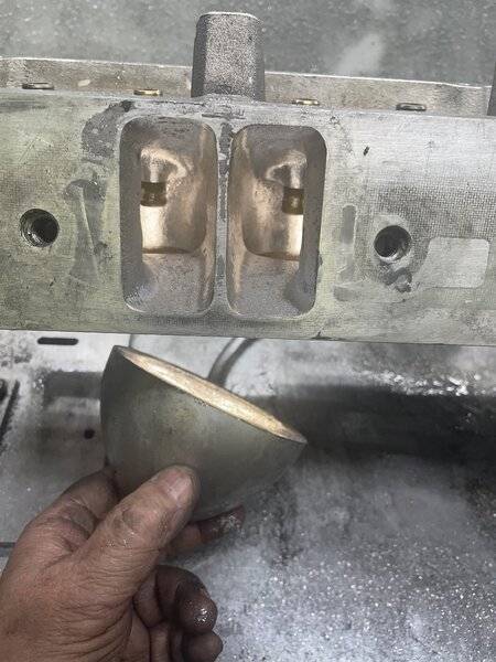

Well I started tubing the second head today and this must have been the second head the guy ported as he stopped short of having to tube the heads. The pinch varies from .990-1.025 so now I can just do my thing and tube them instead of replacing his tubes. My son Matt is bringing the valves this weekend when he comes to visit over Christmas. Pretty sure he’s bring new Pac springs and retainers too. Vic has lots of connections in the racing community so I guess we are going to be trying a smaller diameter, lighter weight spring. Not sure how much visiting and bs’ing Matt and I will be doing on his week home but I may have some flow numbers next week from the first head. This head should be ported and ready for a valve job too. I’m finding out if I come down to the shop more often I can actually turn out some work. I may end up with time this winter to finish my set of heads and get my hands dirty on my 8 sets of LS heads sitting here. Ohhhh he went through the exhaust port into the header bolt holes again. I may try to mark them and try to talk Vic into running studs in at least those holes.
When you are tubing the pushrod holes, are you porting first and then tubing? Or the other way round?
I always tube first so I can port over till I just touch the tubing.

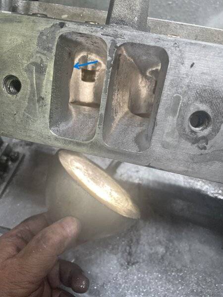

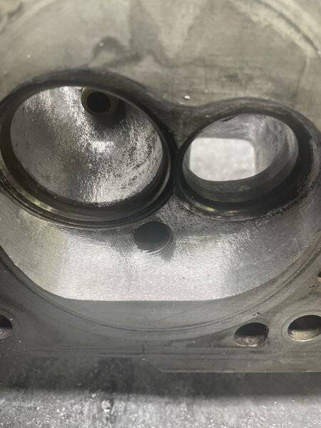

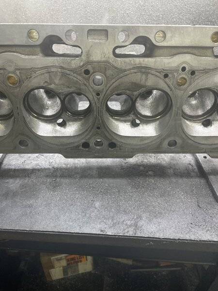

Is this a small bulge or just a light shadow (blue arrow)?

Ya like I said these ports are not finished. I love these rotating stands but after the valve job and after they are off my rotating stands I stand the heads upright to straighten my side walls. That way I’m finish grinding the walls horizontally and not vertically. Every part of these ports are finished and measured at that time them Off to my flowbench. During the finishing process I use two sometime three different chairs to get the right height to visually see each port at different angles.
