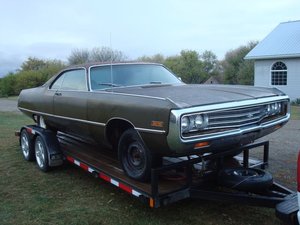

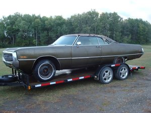

Well in the spirit of getting this project rolling again, I went to a friends place and picked up a 1971 Chrysler Newport Custom for the 489 sure grip,pitman arm and the 11" rear brakes.
Oh yeah, Rob, it's not an A body this time at least:toothy10:
Well I put the 'ol land barge on the hoist, took off the rear wheels,and to my suprise I see the factory keepers on the axle studs. When was the last time you saw a 38 year old car with the original brakes.
I proceeded to take off the drums, and after a little brake clean, I found the brake hardware is like new and the axles are hardly even rusted. This is hard to believe considering this is a Saskatchewan car......
Well the 489 is out, but it is no sure grip....no biggie. I threw in a pre 742 pig in it just so it can be rolled around.
The brakes are put on the shelf until I get my B body housing ready to go.
Now I am looking at the pitman arm, which doesn't look too fun to get off of there. I'm gonna post a question in the steering forum to make sure the swap will do what I want it to.
