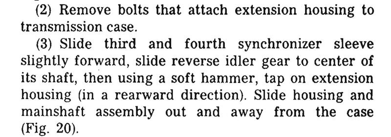

Of course, I've already downloaded the FSM and I saw removing the tailshaft housing involves the complete disassembly of the gearbox :BangHead:
you dont need to disassemble the tranny, crack the bushing with a small screwdriver, then take a bigger one and open the "puzzle" line. See the fine atop the blue line.
