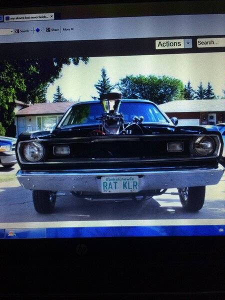

That saying to run a deep pan oil or tranny is just stupid to run less oil/atf. That’s the same effect as running ur stock pan 2 quarts low. Would u do that? Ofcourse not. Kim
This car runs a deep tranny pan with out the extension. Gets checked every 500 runs. 9.03 was its best run. Next year it will be mid 8s. Sadly it now has a glide in it. Kim
