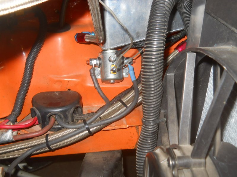

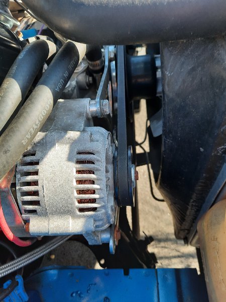

I used a GM one wire. Many different pulleys are available. I mounted my alternator on the power steering bracket. The hole in the alternato was a metric diameter so I used a metric bolt to keep it tight in the alternator. I just retapped the threads american. My positive post was on the frame rail. I used a solenoid for the one wire seen here so I could kill the alternator before a pass . Belt tension was adjusted with a turn buckle with heim ends.

Just remember this. "One wire" is not a cure all, especially if you already have a built in voltage drop problem in the factory wiring, AKA bulkhead/ ammeter. You MUST oversize the charge wire because the voltage sensing is right at the alternator. Otherwise, "down the line," accessories AND THE BATTERY will be running UNDER the proper voltage.
