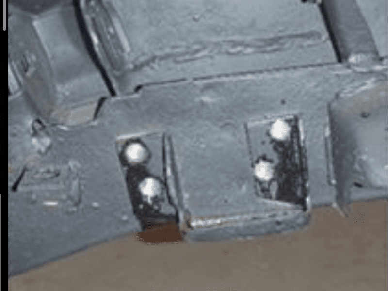

Back to the topic of this thread. Please no more about why I bought or what I should buy unless someone has a complete aftermarket setup to donate. As to the topic, it took me time to get these pictures on this thread. The bracket between the bump stop and the brake line is what needs to be removed. I am not sure if I can leave the tabs which are held on by the spot welds and just cut to that point, or if I have to completely remove the bracket to the chassis. If completely remove, I need some guidance. The coilover brackets are a bolt on item which fasten to the upper shock location and have 4 bolts which go thru the chassis. With what looks like a crush sleeve but is nothing more than a piece of mild steel.
I need to drill the 4 3/8 holes in the chassis, then drill 2 opposing holes to .5 in on the outside of chassis, and drill the other 2 on the inside of the chassis so that the sleeves go thru the .5 in hole and stop on the other side of the chassis at the 3/8 hole.
If there is a better coil over conversion option I could use that would work with my kit, I would consider it. My other option is to see if I can pay a body guy to come to my house and pull this off.
Yes I know about all the rust. Once the fabrication work is done, I will be breaking down the car for blasting and paint work. Hopefully at that time I will have paid down (or off) enough of the IVF medical bill to afford to take a $10k loan out to get that portion of the restore done. I bought the car as a rolling chassis for $2k which is in really great shape. I have 100% perfect floor boards. The car as a whole is in really good shape except for a bad rust spot where the battery is. Complete pictures are on my other thread if your interested.

*Rant ON* Why is it so hard to give people my money??? I tried calling various body shops today looking for someone who would be willing to remove the brackets. A few turned me down and a few tried to tell me how to use a spot weld cutter to do it. One guy wanted to use a plazma torch who I turned down. *Rant Off*
After doing more research today on this task ahead of me. I really dont want to do this work on the chassis as if I go too deep, I then have to pay the vary same person to weld it. Its better for me to just pay the very person to remove the brackets the first time correctly and if they go too deep feel safe in the knowledge that its being filed and repaired correctly. $300 would be worth the less than 1hr it would take to safely remove 6 spot welds per bracket.

I aint the sharpest tack in the box, but if U need to remove those brackets, why dont u get a sawzall and cut them at a steep angle from the outside down , even w/ the frame ? you could even then cut straight up and down from under it to remove the sides that are sticking out, just leaving the frame intact/clean the cuts up w/ a side grinder ------------------?

....you could even then cut straight up and down from under it to remove the sides that are sticking out, just leaving the frame intact/clean the cuts up w/ a side grinder ------------------?

If you are simply looking to remove the factory bump stop bracket.....removing it is SOP when installing a RMS and a few others. The HDK does not, but only because HDK wants the conversion to as reversible as possible for the H-code and specialty cars..... other than a couple of holes.
I would have them off in a few minutes with a grinder / cut-off wheel. About the only way to hurt anything is actually cutting into the frame rail, but even if you did, nothing a little weld and sander can't make new again.

that bracket it cake to get off with a spot weld cutter. you can easily see how thick the bracket is. drill about halfway through it then go little by little till you can smack it with a hammer and it falls off..
Drill spot welds...hit with hammer...there my be a couple on the bottom as well.
