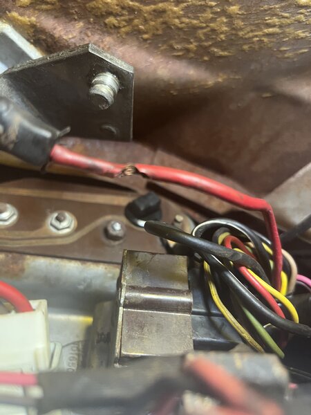

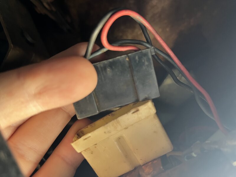

Ok, while trying to get the nut off the red ammeter, the stud just sheered off. Found this connector disconnected ( not Sure what it is) and this on the backside of the red ammeter wire.
Bypass the amp-meter. Fire hazard. Just solidly connect the two wires, and install a volt gauge.
WHAT is that bare cut red wire?
Need a better photo of the question connector, what is it's layout and wire colors
DO YOU HAVE a 74 manual. If not I can MAIL you one but that is the only way, as it's too large to up/ download. Send me a PM/ "conversation."
In the back of the manual past the wiring diagrams are layouts of the connectors, if they are OEM and not added, of course.
Is this the connector?
Wire is not cut all the way through Dell. Looks like somebody was trying to test it at some point
