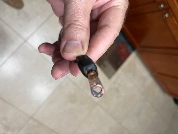

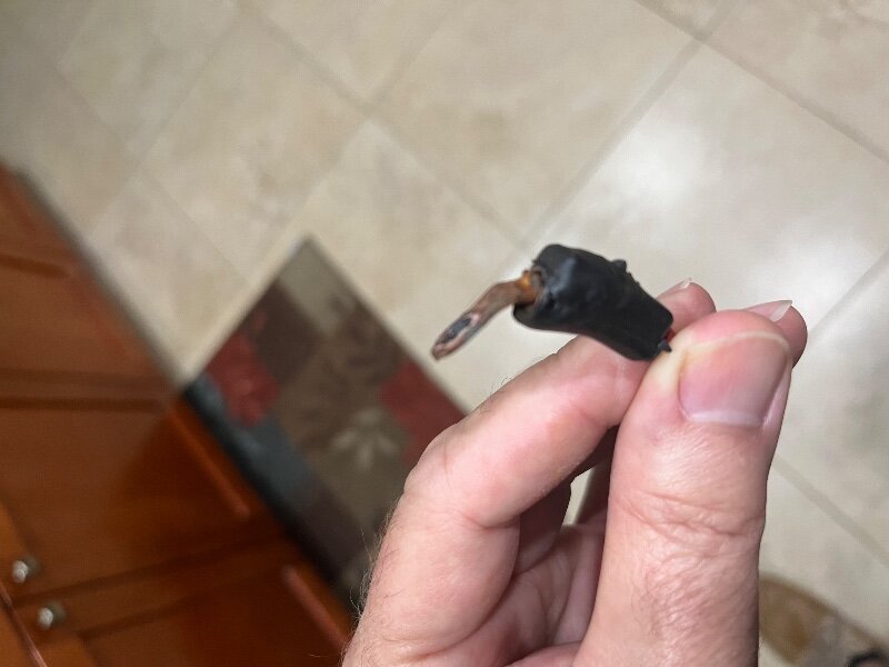

Clipped off the red Terminal, and you guys were right. It looks like the end overheated at some point. Here is a Pic- not looking too good. I was going to splice it in, but it's a little rough. Looks like I don't have a ring terminal that's the right size. I see what you meant by keeping it Mattax
Terrible. Should be obvious. Corrosion can migrate up inside the wire. At the very least cut them off to fresh wire and properly crimp new terminals on. There is no real need to seal them as the factory did. None of the rest of the connector terminals are sealed, AKA the headlight switch, or the ignition switch connector, nor are the bulkhead connectors sealed except minimally around the connector body.
This is from a Jeep but is an example of corrosion at the break in the insulation, and some oxidation (dark) on the conductors under the insulation. If the blue green is under there or its really oxidized, keep cutting back until i stops.
If you're skilled maybe you can save it. Those 12 gage terminations are hard to crimp. You maybe able to reuse the insulation. I haven't experimented enough to say what adhesive will stick to it. Alternative is to heat shrink several layers and/or liquid tape (messy). One thing the insulator there does is reduce the chance of accidental shorts.
Del think back. Almost all of the terminals on the main wires are sealed like that. Even the ring terminal at the alternator got sealed at some point (not all years). I think the downside is that when they do get hot, there is no air circulation to let it cool quickly.

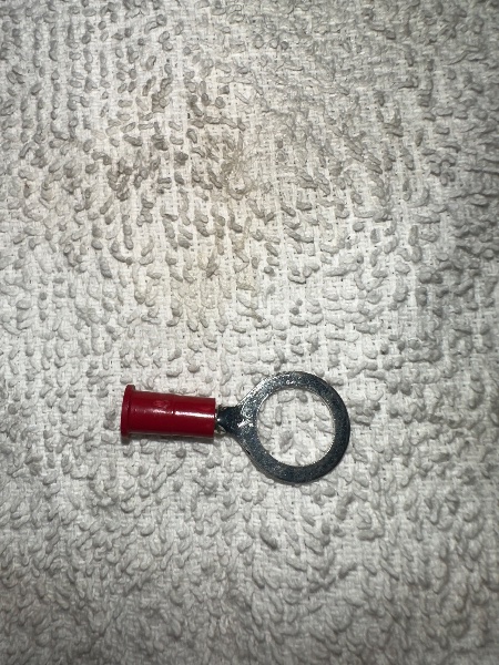

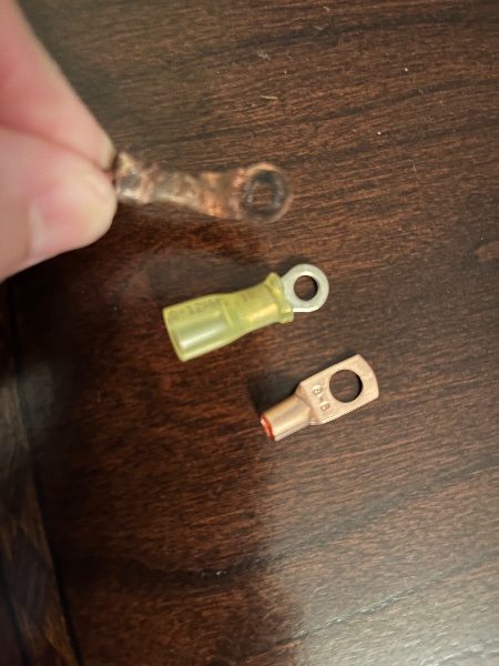

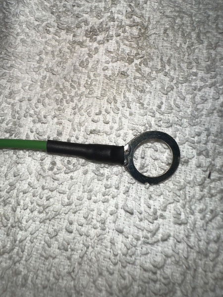

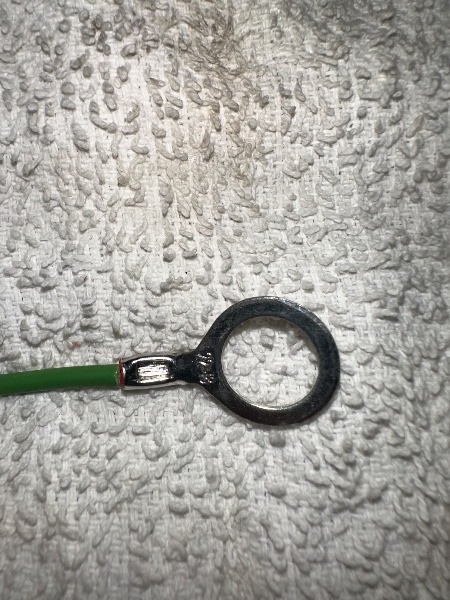

Ok experts, what connector would you use to connect the red amp meter to the black one. I have Heat Shrink to go over everything. Black Amp Meter wire is in good condition.
I think you’re over thinking it. But I’ll add this, any time I use a solderless crimp connector, I pull the plastic insulator off, crimp it lightly, solder it and cover it in heat shrink. Works a charm.
