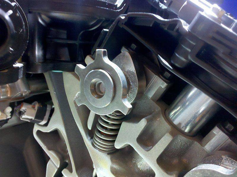

BTW, this is the cut away of a 3.5L Ecoboost Ford engine. There's no roller there. Uses 5W-20 SM Oil. They do direct acting mechanical buckets for packaging space and cost reduction. They use materials engineering to take care of the wear.
Here's an article.
ZDDP: When, Where, What, Why, How?
"In 1992, an API-rated SH oil contained 1,200 parts per million (ppm) of phosphorus; in 1996 SJ contained 1,000 ppm. It was not until 2001, when the rating went to SL, that we all started to see camshaft problems appear.
So appears to be mid 90s, and they still currently make vehicles without roller camshafts in OHC, if it's designed around it, it will work. Just takes materials/coatings.
