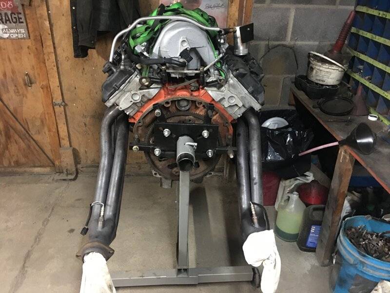

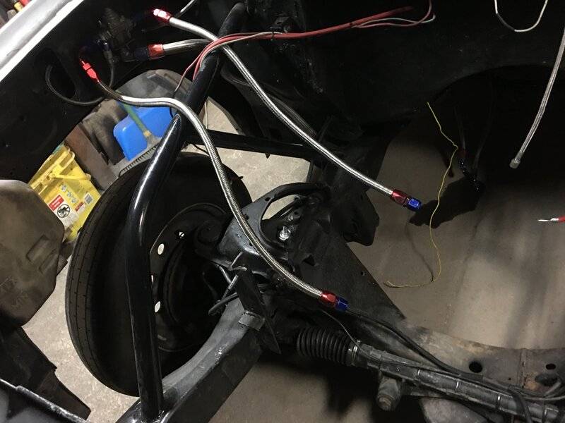

I meant to tell you the long tube headers in the pictures are from a Jeep. They fit with a few dings by lifting the cab about 7/8 inch with e bay aluminum stock biscuits and adding poly cab mounts. He is fortunate enough that the truck was originally a 4 cylinder 5 speed with manual steering. You cannot find new manual racks anywhere. The other interference point is the reinforcement sections that stick out on the inside of the frame next to the transmission. Those really could stand to be cut and replaced with a piece of flat steel, but putting a ratchet strap around the collectors and pulling them together allows them to slide in. The only starter I've heard that actually works like it's supposed to without problems with a Gen3 and a 727 is the Tilton/ATI unit. So far nothing has been inexpensive playing at this level. Oddly enough, everything worked flawlessly around the starter except, of all things, the engine oil dipstick tube, which had to be mercilessly modified in order to fit with it and the headers.

Like I say, they’re tight, but we can install the engine with them bolted to it. That’s a huge advantage with the bolt flange bolt pattern on them in the confines of the tin can on wheels.

Well I ended up buy a built 6.1 stroked to a 420. Makes around 650-700 hp. Going to put it in my dakota. I will be useing the 904 that I have been useing with my 360 magnum. I finally found a guy selling some stainless works long tube headers. They came off his 5.7 jeep grand Cherokee . But I don't remember what year his was. I did replace all my body mounts with polyurethane ones. Not sure I am understanding you, but you said you had to run 7/8 spacers on top of the mounts to get the headers to clear? Got any pics of your friends dakota with the headers mounted and showing the trouble spots you was talking about? My engine came with the drag pack oil pan. It is still rear sump but the sump is longer than the holley swap pan I bought. So looks like I might have to cut a big notch in the front cross frame to get it to fit.
