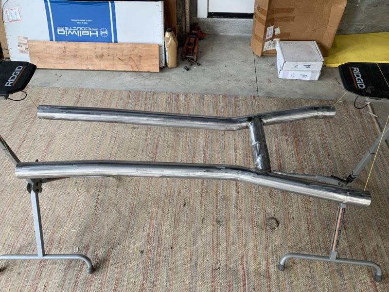

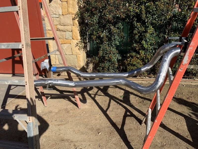

I just used it on my tti exhaust pipes I restored. This stuff is awesome. Easy to spray IMO. Air cured glacier silver 1800-2000* high temp spec. I can’t wait to try their micro clear coat.

will work perfectly. use the high temp exhaust line. Ive used glacier silver (seen above) and the black and the titanium. the titanium is a goldish-tan color. all in air cure just make sure the parts are CLEAN. use acetone.

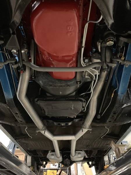

heres a few more auto parts I've done. lost a lot of pics when my hard drive crashed. this is more of the carb
