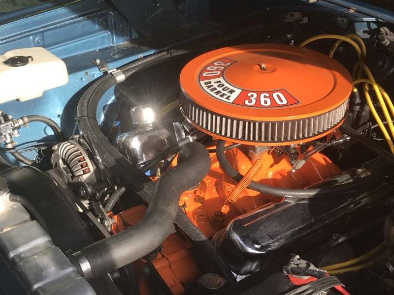

Anyone install Edlebrock aluminum heads ?
Ok, thank you. Maybe, I ll just port heads and intake. Or save it for a day when I take it to a builder and have pistons and cam examined for the right combination. But, that’s going to cost a minimum of 3-5 grand. Which I was trying to avoid. Especially based on other people having the same exact engine. With no lower mods, same intake. Difference is piston and cam specs I guess. Or it won’t work.

You need to know the lift of your cam, then x1.5 that will give you your valve lift........
If you have a lot of lift and you shave your heads down..........the valves get closer to the piston.......if they are close now it might hit afterward. bent valve = no compression in that cyl.
If you have a small cam, say .430 lift and alu aftermarket head will not give you much bang for the buck.....but a .450 to .480 lift cam may wake it right up.
OK ok lets start from the TOP!
What gear ratio do you have?????????
Do you have a tachometer??????
What rpm does you combo stall at now. aka left foot on the brake as hard as you can and mash the skinny pedal with your right, to the floor. look at tach........what rpm did it go too???????
What intake manifold do you have on it right now?????
exhaust manifold or headers??????
Answer all of these and we have a start of spending all of "your" money in the right direction.................

2.94 gearing. I like that gearing because of high interstate speed limits and I don’t clown around. Other than punching it down once in a while. I just like having enough power when I want it on rare occasions. Rpm performer intake. Needs replaced with air gap/crossover deleted. Yes, tach. Stock headers. 4 barrel Edlebrock calibrated by me. Never checked what rpm it stalls at. The engine is a tad sluggish at low to mid rpms. At 2500 to 3500 it makes very good power. Mid to top end. Kind of expected with an aftermarket cam and gearing I have.
stock LA heads stall around .485 lift. Your cam will need to be bigger for a gain in power with your new aluminum heads
Aluminum heads shed heat better than iron and need more compression to make the same power as their iron counterparts. On a stockish small block going to aluminum may gain nothing.
Adding a bigger cam moves you from street to quarter mile territory and now you need more gear and converter because of poor lo rpm street performance.
For the guys that just added aluminum heads and got more power i'd want to see the dyno sheets, unless their original heads had poor flow.

Try a set of 3.23's. Easier than swapping heads.
Yeah, you’re absolutely correct. I can always hold onto the 2 and sale one perhaps. That I don’t want to hold onto. Very good suggestion. But, I do like higher gearing. Maybe, 323’s will give me what I’m looking for. It’s a very practical suggestion to try. If I don’t like it. It’s easy to swap or sale. I’ve removed mine once to fix a leak.

Thank you, sounds like you know what your talking about. I think for the next couple years. I’m probably going to port my stock heads and Edlebrock intake. And go with a 3.23 as recommended. If that doesn’t make me happy. I’ll start dumping more money.
Gears and converter may be your best improvement, but don't change that rpm intake. What is the diameter of your rear tires?
