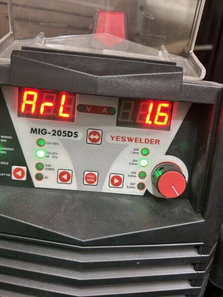

I bought a Yeswelder 205DS a few years ago because it got great reviews for an inexpensive welder.
Problem is that I can’t understand what the settings readout means ! It’s jibberish !
I am beginner welder but understand the wire feed speed and amperage settings need to be correct.
Whot know how to interpret these readouts ?

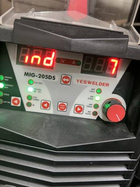

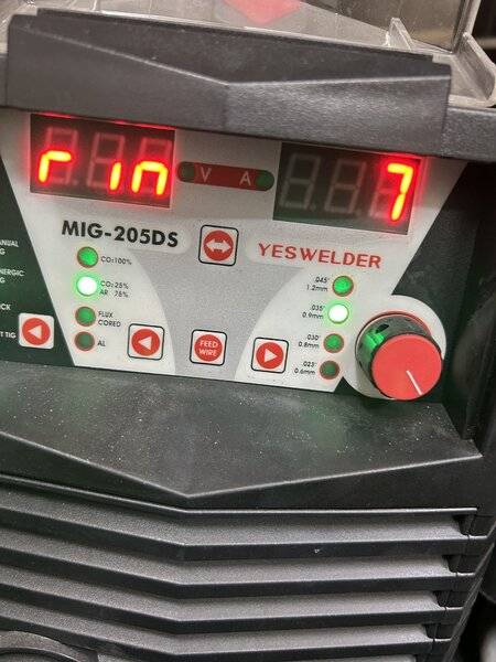

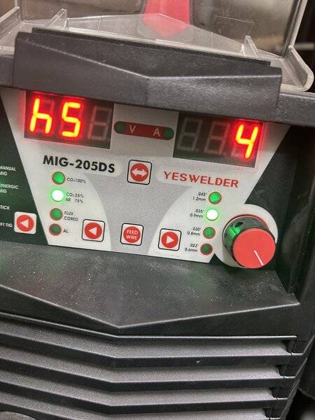

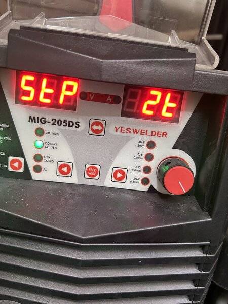

Here is my display . I can’t understand what they mean . I know (think) AMP means amperage….
Set it to manual MIG
I did for some of those readouts . My daughter is a professional welder and didn’t know what the readouts meant. I wish I could run a bead like she can ! Als I am in Boise and she is in Denver .
Those are the tig settings so he is scrolling through a set up menu
Yes .. I was scrolling through the menu. I guess if one is an experienced welder you might be able to guess what they mean . Obviously people are able to use this welder successfully… it just doesn’t make sense to me. Seems like they could use acronyms that are easier to decipher.
the settings look to be wire size , shielding gas type , mode , heat , wire speed .
Ok …. Which is which ?
bbt = ?
r in = ?
Stp = ( trigger mode ?)
ArL = ?
Ind =? ( induction?)
Maybe if I was experienced with multiple welders I would know but Angela was perplexed as well . But she is most likely using Millers and Lincoln the vast majority of the time…
I have the same Yes welder you do and it welds great. I use manual Mig and just set the speed and heat. Somewhere I have a manual I found online when I got it that explains all the codes. I think its on my home PC, I'll need to look when I'm there.
I just bought the lift tig stuff for my dad and I to play with.
Found this on Reddit - use with caution :) Again I think you are scrolling through settings and you need to get out of that mode and get into manual MIG mode. The manual isn't great and my Miller Autoset is much simpler but the digital stuff is what you get these days.
V/U - VOLTAGE A/I - CURRENT(A) Cur/cur - CURRENT ArL/arl - ARC LENGTH (SYN MODE) Dp/ DP - DOUBLE PULSED PrG/prg - PRE GAS PoG/pog - POST GAS GAS/gas - GAS CHECKING SYn/syn - SYNERGIC MIG SETTING H5/HS - HOT START CURRENT r in/rin - FEEDER SPEED(Arc start/inching) bbt - END ARC CURRENT h5/hs - ARC START CURRENT SPt/spt - SPOT TIME ind - INDUCTOR Ant - ANTI STICK diG/dig - ARC FORCE PoG/pog - POST GAS FEd/fed - INCHING Frq - FREQUENCY duY/DUY - DUTY CYCLE Vrd/VRD - ANTI- ELECTRIC SHOCK FUNCTION

From your pic which is only half the machine it is set for .035 wire size and 25%CO2 AND 75% argon shielding and sync mode which is auto heat selection i think . Manual mig would let you set heat and wire speed manually i think . To find which knob is wire speed hold the trigger in and turn a knob if the wire comes out faster it is the wire speed knob and the other knob would be heat . There are probally other settings for stich welding and spot welding and looks like tig and stick just avoid them if only mig welding . this is all a guess from what i saw in your pic . good luck .
