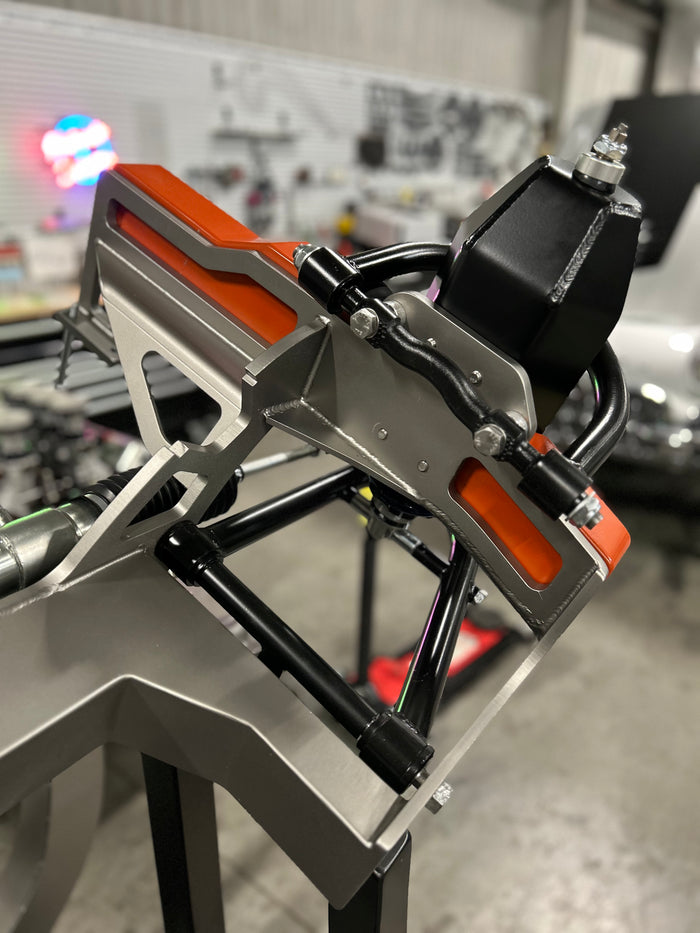

Looks like this kit does away with the stock UCA mounts. Not advocating that it is in anyway better than anything else (HDK or stock), but it does potentially give a clean sheet design.

Hammer Fab does some great looking work. I followed along as they designed that suspension kit. I'm not a fan of how much you have to cut out of the frame raits to install their kit.
There's also no evidence to prove their kit is any better at "handling" or if the geometry is reallyh any better than any of the other current A-body susension offerings.
If I was going away from torsion bars, I think I would do a generic kit from Detroit Speed or something similar. Something that isn’t using the stock UCA mounts and is engineered for handling. Remove the compromise and start from scratch.

Completely agree on both counts. I don’t like the cut either, and no argument that it isn’t a guarantee that the geometry is actually better.
